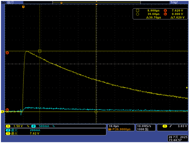

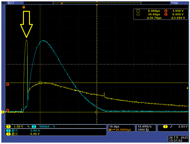

As shown in the figure, I have three key observations for this test. Please refer to the graph below, which shows an 8/20µs surge signal. Observe the voltage and current changes of the TVS. The blue waveform represents the current, and the yellow waveform represents the voltage change.
1. When the TVS operates, I would like to understand the spike voltage changes generated by different low-voltage surge signals (as indicated by the arrows) when the TVS activates. (This phenomenon is not apparent from the clamping voltage presented in the datasheet.)
2. When the TVS is actuated, the voltage behavior (spike peak voltage, clamping voltage) is measured when the leakage current is less than and close to the Ipp current.
3. When the TVS is actuated, the voltage behavior (spike peak voltage, clamping voltage) is measured when the leakage current is greater than and close to the Ipp current.

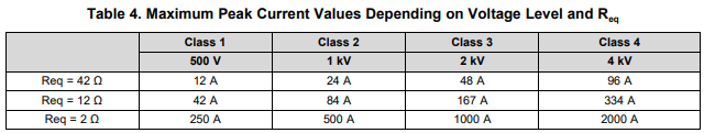

    I'm not sure if this will address this point, but there is a table of expected current values to support various levels of surge testing in IEC 61000-4-5, shown below:
    More information can be found here. Typically, for data lines (which I am guessing this device is being placed on because of the channel count and capacitance levels), we use the 42Ω Req.
    Clamping voltage is typically derived from ~30ns into a clamping waveform. The initial peak duration is based on the turn-on time of the diode, which in most cases is <5ns or even <1ns in some cases. Although the spike voltage is very high, because it is only present for a very short amount of time, it often does not cause any damage.

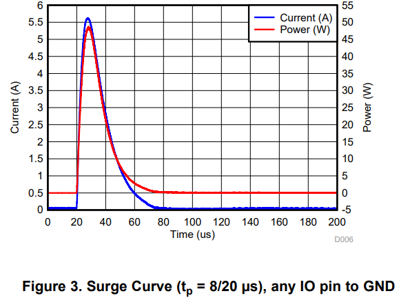

    We do not have any such test reports, but we do have a Surge Curve in our datasheet that might be of interest (see below).
    This graph models the power across the device's maximum surge rating, which indicates that at the maximum ratings, the device will clamp around 9-10 volts.
