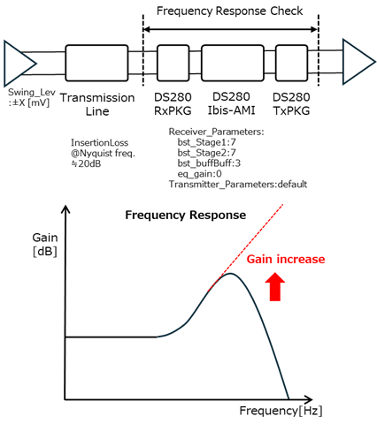

  • Dear E2E team,
    Thank you for your response. Furthermore, I would like to inquire for more details.
    I am checking the frequency response between the input and output in the DS280's Ibis-AMI (including the package). As I increase the output amplitude of the Tx Driver (Swing_Lev=±X[mV] in the figure), the gain in the high-frequency range of the frequency response between the input and output increases.
    When the output amplitude of the Tx Driver is ±50mV, a typical frequency response of a 2pole-1zero CTLE is observed. However, as I increase the amplitude to ±100mV, ±200mV, and so on, the gain in the high-frequency range continues to increase. What kind of functionality leads to this characteristic?

  • Hi Akimaru-san,
    The DS280BR8x0 can operate as a linear or limiting redriver depending on how its configured.  In the IBIS-AMI model, this is controlled by the `sel_fir` variable.  Which mode is the sel_fir variable in?  If you change it, does this impact your observations?

  • Hi Drew,
    Thank you for your confirmation.
    I am using "sel_fir" at "0" (default linear mode).
    I switched to "sel_fir=1" and checked it. The output amplitude of the DS280 changed,
    but there was no change in the behavior I mentioned in my previous communication.

  • Hi Akimaru-san,
    Thanks for confirming which transmitter mode you're using.
    Is it possible for you to share your ADS project?  I'd like to take a look at this behavior.
