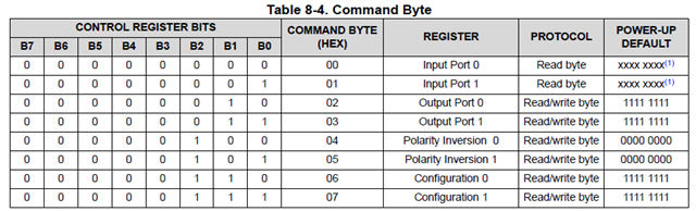

  • Hi  ,
    we are trying to achieve LED blink from U-Boot for 1 Sec On / Off time interval (Automatically). Once after configuring the register the controller can able to flash the LED based on the timing configure.
    In TCA6416A  I see only the bellow list of register where we can configure it to Either On / Off.
  • Hi Avinash,
    The "automatic" capability is not possible. Each second, you would need to write I2C commands to change LED state.
    TCA6507 might be your device since this LED driver can be configured to pulse LED's in a specific way through registers 0x00 - 0x08.
