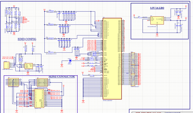

Can Someboady help me verify the schematics of TFP401APZP , im trying to display oled from HDMI , currently board is not working. i get no activity from any of the hdmi and rgb signals.

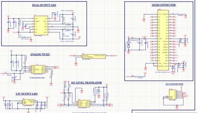

Where does HPD signal for the HDMI come from? I see the HPD signal on the HDMI connector, but I do not see HPD connection anywhere else. I also do not see HPD signal coming from the OLED connector. Can you verify that the source has HPD connection that goes high when it is connected to the OLED monitor?
