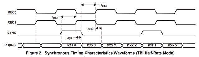

Q1. Could you tell which signal RBC0 would be synchronized?

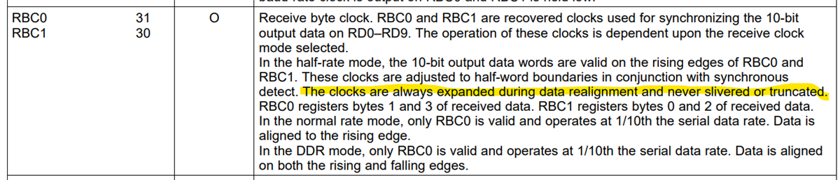

Q2. According to the datasheet as below, RBC0/RBC1 would be stretched. But are there any chances that RBC0/RBC1 would be shortened?
Q3. Does TLK1201 have same behaviors with TLK1211 regarding the specifications I asked in Q1, Q2?
