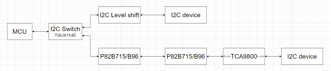

I want to use P82B715 or P82B96 to extend my I2C bus to about 10m,but the device on remote side work on a voltage of 1.25V,so I need a level shift to change voltage from P82B715/P82B96(3.3V or 5V) to 1.25V,and consider about VOL for remote device,my plan is below:connect a TCA9800 B-side on remote side of P82B715/P82B96,and the A-side of TCA9800 connector to remote I2C device,is this plan can work OK?
the total system topology show below:

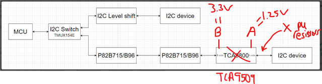

  • Hi Zhiqiang,

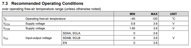

    The TCA9800 has the following limitation for B-side voltage:
    VCCB >= 1.65V.
    You can't flip the buffer so that A-side faces the 1.25V device since this would mean that the internal current source on B-side faces the P82B96. This would also not work. B-side's ICS will be sensitive to the output side of the P82B96/715.
    The output voltage on Sx/Sy side of P82B96 is 1V max.
    If TCA9800 A-side VCCA = 3.3V, VIL = 0.3 x 3.3V = 0.99 V. P82B96 VOL should be within spec as long as the max range is not hit (off by about 0.01 V).
    Since TCA9800 can only go down to 1.65V on B-side, you might consider using TCA9509
    TCA9509 has static voltage offset side on A-side, which can face the 1.25V target device (remove all PU resistors on A-side of this buffer).
    TCA9509 B-side can face P82B96/715C since VILB = 0.3 x VCCB, VCCB can be 3.3V on TCA9509.
    Final block diagram would look something like this:
    What data rate are you attempting to run at? This type of implementation with TMUX154E --> P82B96 --> 10 meter cable --> P82B96 --> TCA9509 --> I2C device introduces significant amounts of prop delay. You might need to reduce the clock speed of your I2C bus in order for this to work and to account for round trip delay.
    Tyler

    on the reply,your mention that TCA9800 B-side can not work below 1.65V,but on my design,if TCA9800 B-side connect to P82B715/96,the voltage on B-side is 3.3V or 5V,that is higher than 1.65V which meet the requirement of TCA9800 B-side,so I don't understand why the TCA9800 B-side can't work with P82B96/715?
    the speed for I2C is 400kHz,can this speed work on this length?
    finally,I'm seeking a device that can extend I2C bus to 10m+(20m is better),and the i2C device is sensitive to the VOL when work on 1.25V,so I need a level shift can bridge the voltage between I2C range extender and I2C device(integrated with range extender also accepted),and as refer above,the PU resistor on I2C device can't be remove,so do you have suggested device or combine?
  • HI Zhiqiang,
    TCA9800 B-side cannot connect to the P82B715 due to internal current source. Therefore, it would need to face the 1.25V side.

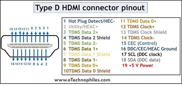

    I found this example pinout online. Is the HDMI standard including SCL/SDA on the cable?
    I know in the past that customers have used TCA9509 to solve some use cases with HDMI-DDC standard. I think it is in the same format that I suggested to you.

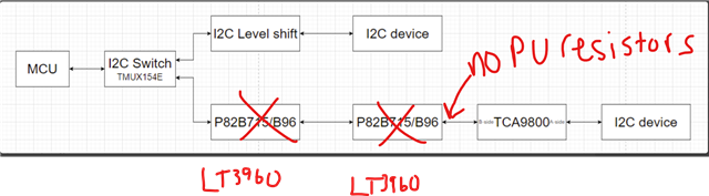

  • Hi Zhiqiang,
    You can tell it won't work based off the limitations of the static voltage offset or current source internal to the device.
    TCA9800 has had problems in the past with having the ICS (internal current source) facing large offset buffers like P82B96. Usually there are PU resistors on both sides of the large offset buffers, which cannot exist on the B-side of the TCA9800. Also, the VILB = 0.3 x VCCB = 0.99V. VOL(max) of P82B96 can be up to 1 V which is technically outside spec.
    For TCA9617B, its the VIL requirement in order to propagate a low across the buffer. The b-side has VIL limitations which can make it difficult to transmit a LOW if your output from the buffer extended is too high. P82B96 VOL = 1 V max >>> VIL = 400 mV of TCA9617B.
    However I looked at LT3960. It output low votlage on SDA/SCL looks <400 mV. You might be able to use TCA9800 B-side facing the differential buffer as long as you remove the PU resistors on b-side:
    This looks more promising than using P82B96 due to the large VOL offset P82B96 produces.
    Tyler
