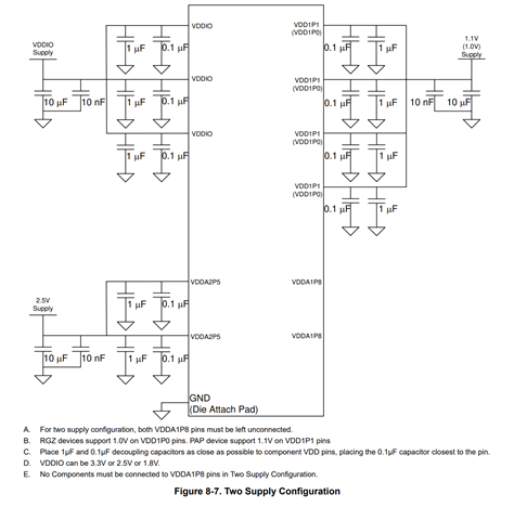

DP83867IR: Regarding the 1.8V power supply.
Part Number: DP83867IR
Other Parts Discussed in Thread: AM5708
I'm connecting it to an AM5708.
I'm configuring it based on the circuit of the evaluation board below.
DRA71x/DRA79x/TDA2Ex17/AM570x CPU Board Schematic Rev D (Rev. B)
This configuration does not use 1.8V, but my circuit uses a 25MHz oscillator, so I need 1.8V as the oscillator power supply.
In this case, is it okay not to connect a 1.8V power supply to VDDA1P8?
I'm in a hurry as I'm currently in the design stage, so I would appreciate a quick reply in the comments.
