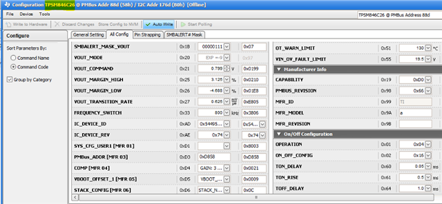

  • Hi Jay,
    The TPSM846C23 is a PMBus device so you got to make sure to communicate using PMBus 1.3 protocol. The way this device is typically sampled is by ordering the EVM which you already have done but additionally you can order USB2GPIO2 to connect device to computer and download our GUI to have access to all the digital features.
    This is how USB2GPIO2 dongle get connected in out EVM:
    https://www.ti.com/lit/ug/slvub26d/slvub26d.pdf#page=7
    That way you don't have to do any coding or worry about doing write it a specific way, as that setup up along with our GUI automatically will recognize the TPSM846C23 device and display all the commands, along with the read values. It has a lot of functionality like monitor tab to keep up with IOUT/VOUT/TEMP etc., STATUS tab to keep track of specific error/s, and all commands page:
    I have not tried it with raspberry pi but the above should work.
    Eileen

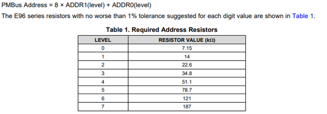

    Another thing I forgot to mention is I2C communication has certain addresses reserved for special functions (don't know which ones), so be careful when selecting the device address thru ADDR0 and ADDR1 resistors.
  • Hi Eileen,
    Yes, I am aware of these and the SDA SCL pin.. Its just whenever i measure SDA and SCL pins I don't see any voltages which it typically 3-5V.

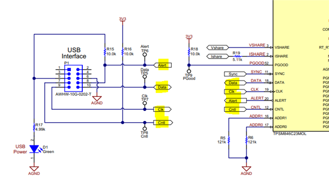

  • Hi Jay,

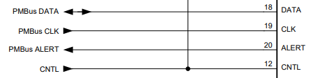

    Earlier I added image of the voltages for those pins. Typically we have pull up resistors to ensure voltage stays low/high, but that is with our setup. I believe SDA and SCL raspberry pi lines should have internal pull up resistors, in which case you probably don't need to add it. If you aren't sure you can try an add some externally. If lines don't have pull ups, they will float and you wont read voltage.

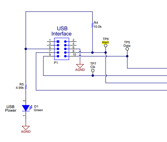

  • Hi Eileen,
    Sorry I overlooked first image you shared. On the pin#7 of the USB interface which is the CNTRL pin you added a 3.3V supply which is also tied up with PGOOD. Is the 3.3V coming from external supply?
    If I look at the original schematics.. there is already a 3.3V  coming from the BP3 pin of the chip going to CNTRL and PGOOD.
    Jay

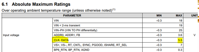

  • Hi Jay,
    The image I had attached earlier was from the 2PH EVM schematic, they named 3V3 for BP3, it should be the same thing. No external source.
    Another thing, you mentioned SDA and SCL pins are typically 3-5V. Make sure it doesn't go above abs max as its close:
  • Hi Eileen,
    Thats point taken.
    Raspberry pi I2c is also 3.3V - 5V range so it should be fine. My existing problem is I couldn't get any output voltage from the SDA and SCL pin of the TPSM module :( .. while SDA of SCL pin of Raspberry Pi are verified with 3.3V output.

  • Hi Jay,
    I looked a bit deeper into this and our typical setup. There is some connection in the USB2PIO userguide for reference. Based on that, it looks like SDA/SCL = DATA/CLK lines have pull up resistors to enable those communication lines.
    Our GUI and USB2GPIO setup has multiple options of pull up resistors 668 Ω, 1.1 kΩ, 2.2 kΩ, or open drain but 2.2kΩ (is typical for 400kHz "fast mode" speed) to a 3.3V source. I'm guessing your SDA/SCL lines are open drain and therefore pulling low.
    You can check your raspberry pi UG to see if this is already included internally and if you just have to do something to enable it.
    Let me know if that ends up working.

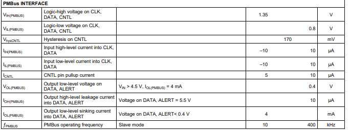

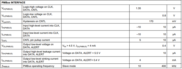

  • Because TPSM is PMBus, the device itself should be able to support i2c.
    If you are having issues getting the lines up (default state), that probably has something to do with the connections itself either the pull up resistor value or the voltage. Some raspberry pi need internal pullup/down resistors to be enabled/disabled through libraries, with that been said double check that raspberry pi isn't pull down by default. Also, there's probably a mismatch with the voltage of the DATA+CLK pins vs SCL/SDA pins, to where you may need a bidirectional logic level converter to ensure both devices read the correct V for high level.
    TPSM values are given on DS:
  • Hi Eileen,
    As mentioned earlier, pull up resistors already enabled in Rasp-pi both external and internal.
    And Fyi. Other i2c module that i tried with Raspberry working without problems except for this module. Thanks for the help anyway.
  • Hi Jay,
    Did you try adding bidirectional logic level converter for proper V read? raspberry and module probably have a difference in V.

  • On the EVM schematic and actual EVM board, P1 is marked below pin9 which is telling us the orientation making pin9 = CLK. However, the correct pin config is upside down. so, i have to flip it.
