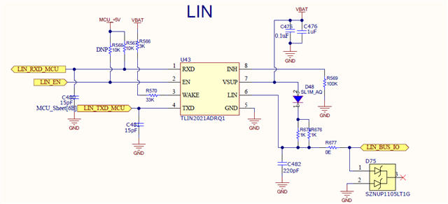

  •  Please review our circuit. Also where to add ferrite and capacitor as per your earlir post. on VBUS line.

  • Hi Manoj,
    Please see my feedback below:
    • Remove one of the pullup resistors on the LIN bus. The LIN standard says the commander node should only have 1k Ohm pullup resistance.
    • I would recommend replacing SZNUP1105 with a 36 V TVS diode like TSD36C-Q1 if you plan on using this for 24 V applications.
    • I would NOT reccomend adding 100 nF capacitors to the bus as Sunilbhai suggested earlier. The max allowable capacitance on a LIN bus is 10 nF, so 100 nF will cause issues.
    Outside of that everything else looks good.
    Matt
  • Corrected Recommendation:
    • Ferrite Bead: Place a ferrite bead (e.g., BLM21PG221SN1, 220 Ω at 100 MHz) in series with the TLIN2021A-Q1 LIN pin, close to the pin (<1 cm), to suppress EMI.
    • Capacitor: Use a 100 pF (not 100 nF) ceramic capacitor from the LIN pin to ground on the device side of the ferrite bead for high-frequency filtering and ESD protection.
    • LIN Pull-Up: Ensure a single 1 kΩ pull-up to VSUP at the commander node, removing extras.
    • TVS Diode: Use a 36 V TVS diode (e.g., TSD36C-Q1) for 24 V applications.
    • Test: Verify LIN bus signal integrity (rise/fall times <5 µs) with an oscilloscope.
