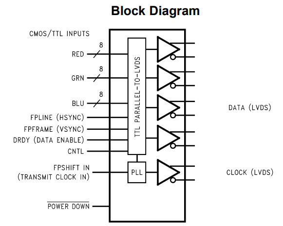

Part Number: DS90C385A
hello, my customer wants to replace this material. Do you have any recommended materials? Value price more than performance.

Hi Kyle,
I want to summarize the following information:
The device is RGB888 input (parallel CMOS/TTL interface) to x4 LVDS channel output (+ Clock).

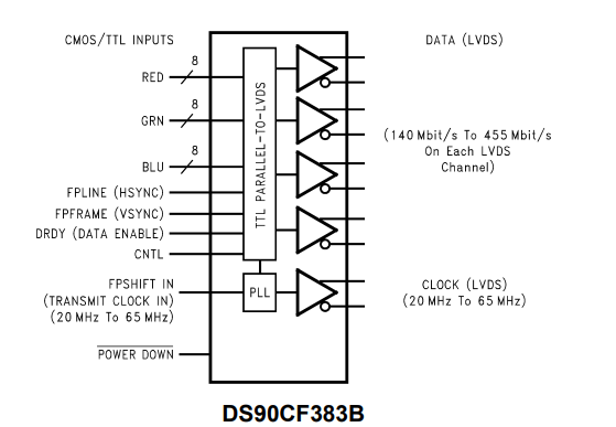

I did find this part that may be cheaper and applicable for this application, please see below:
DS90CF383B 3.3V Prog LVDS Transm 24-Bit FPD Link-65 MHz datasheet (Rev. E)
Let me know if you have any further questions about this replacement.
