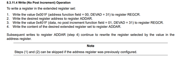

My customer want to use DP83826I in Motor driver. And find that they can not write address 25h register.
They can successfully write resisgter 27h and 18h.
Q1:  Does 25h register support write instruction?
Q2: If answer is right, are there any reason why customer can not write it successfully.
