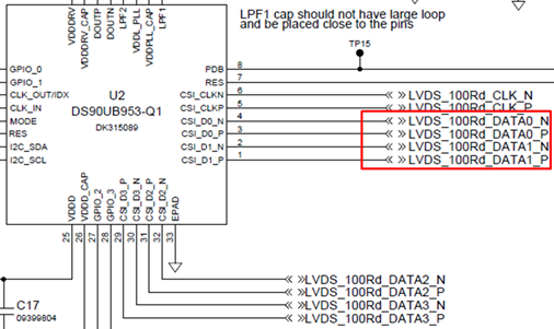

  • hich LVDS signal are you talking about? Are you talking about LOCK being lost between the Serializer and Deserializer? pins 1, 2, 3, 4 from 953 device, Signals are dropping when the failure presents

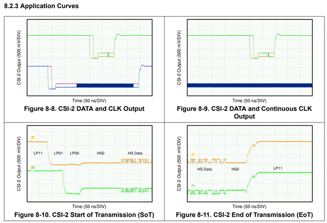

    Are you probing these MIPI CSI signals with a high-speed probe? Can you able to provide an image of the scope captures?
    We typically expect the signal to look like below:

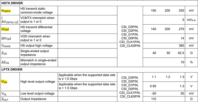

    In Low Power (No data transmission), we expect the voltage to be around 1.1V. In active data transmission, we expect a differential voltage between 140mV to 270mV, with a common-mode voltage between 150mV to 250mV. Are you seeing something similar in your passing or failing cases?

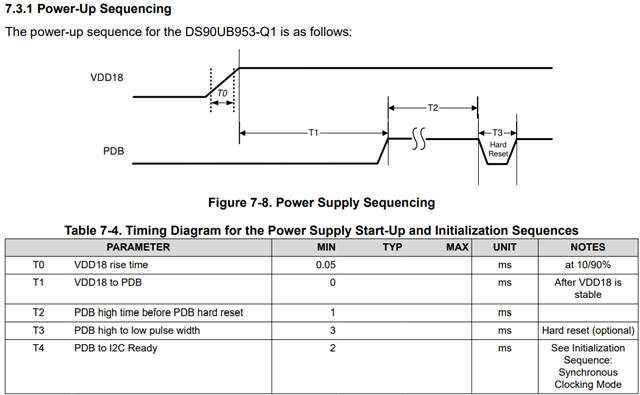

    The 953 is also just acting as a MIPI receiver. When it receives video data by the MIPI transmitter, it will enable termination and receive the data. Can you confirm that all of the 953 power rails are stable and that the power-up sequence has been followed?
