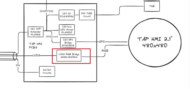

Hi team,
Can you help to check whether SN65LVDS86A works here for the post stage component?

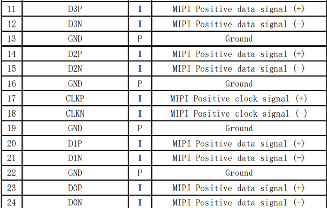

Attachment is the datasheet of the post stage: TCXD070IBLMA-179 SPEC V1.0111.pdf

  • Hi Rannie,
    I have a few questions,
    #1 - the data sheet of the post stage shows a 7-inch display which includes MIPI interface, set for this resolution: 1024 x 3(RGB) x 600.
    • This seems different than the TAP HMI 2.1" 480 x 480 on the block diagram, can you please confirm?
    The SN65LVDS86A can support from 31 to 68 MHz frequency range, with a 21-bit frame with 18-Bit color depth.
    I am not certain the interface is compatible with the 7-in. display (it is not a parallel interface).
    #2 For the TAP HMI, the estimated timings are:
    • 480 * 480 * (1.2 for estimated blanking) * 60 fps = 16.58 MHz PCLK.
    I would need the specification for the TAP HMI display to confirm, but I anticipate this may be outside of the minimum CLK range of the SN65LVDS86A device.
    Please let me know if you have any questions.
