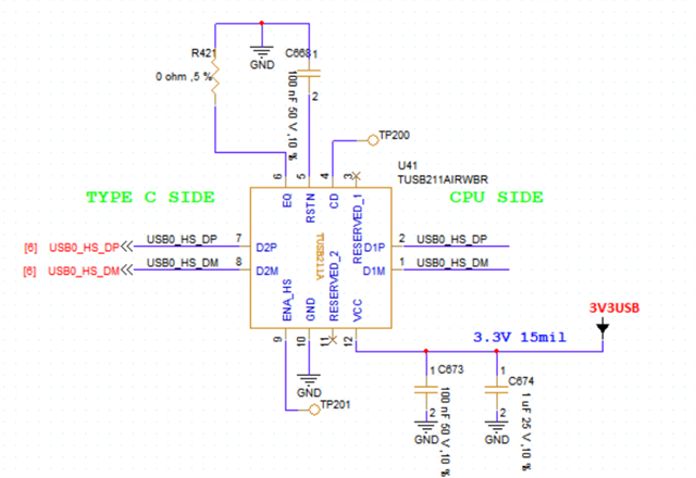

HI ,Please help to check the schematic ,if need to modify , RSTN no need external pull high, right ?
and layout , need PIN2 to short to PIN7 PIN1 to short to PIN8 ,right?
Yes, RSTN does not need to be pulled high, it can be connected to ground with a 100nF capacitor.
Yes, correct. Beneath the TUSB211A, the DP/DM lanes should be shorted across these pins, as the TUSB211A does not actually carry the signal through the device.
Otherwise, schematic looks good.

Thank you ,Sir
The TUSB211A (D1P/D2P) is direction-independent, right?
The D1P can be connected to a USB connector or a SoC, right?
Yes, correct, the TUSB211A is direction agnostic. Just ensure that the D1/2P pins connect to the DP lane.
