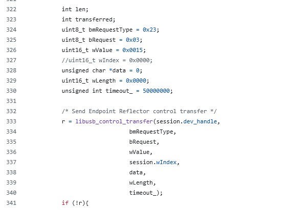

Hello
I am currently performing USB 2.0 downstream compliance testing using the AM6412 and TUSB8042A.
I am using Linux as my OS.
Tests 1 through 3 were successfully completed.
1. Host Full-Speed ​​Signal Quality and Transition Time Test
2. Host Hi-Speed ​​Signal Quality Test
3. Host Test J/K, SE0_NAK
However, tests 4 through 7 could not be completed due to issues such as waveforms not appearing.
4. Host Controller Packet Parameters
5. Host CHIRP
6. Host Suspend/Resume Timing
7. Host Low-Speed ​​Signal Quality and Transition Time Test
Please let me know if there are any register settings required to perform tests 4 through 7.
