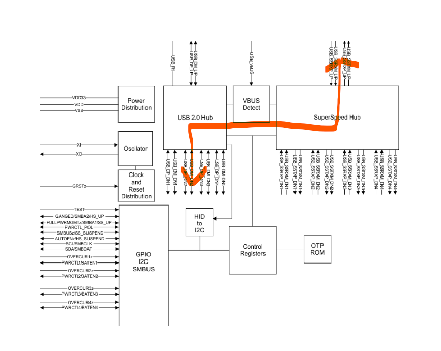

My customer want to use TUSB8044A achieve the function of upstream only by USB3.0 and downstream only by 2 or 4x USB2.0.
Customer use 2x or 4x 480M USB2.0 cameras. So the data bandwidth on USB2.0 is hugh. They don't want to let USB HUB connect with MCU by USB2.0. It will limit 4x cameras data.
Q1: If customer can use TUSB8044A to achieve upstream only by USB3.0 and downstream only by 2 or 4x USB2.0
