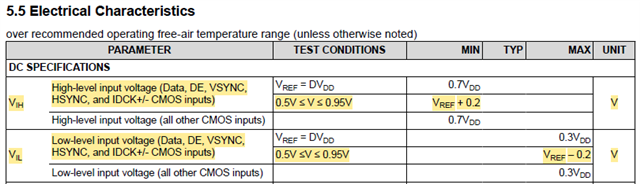

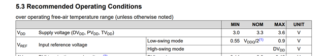

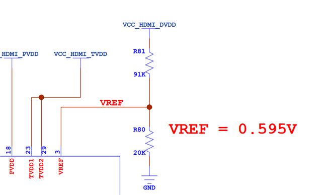

Dear TI Team,
I am planning to use TFP410 in my design to convert RGB888 data to HDMI and the SoC operating voltage for the RGB and other control signals are 1.2V.
Is it possible to connect the RGB888 and other control signals which are working at 1.2V directly to the TFP410 input data pins?
