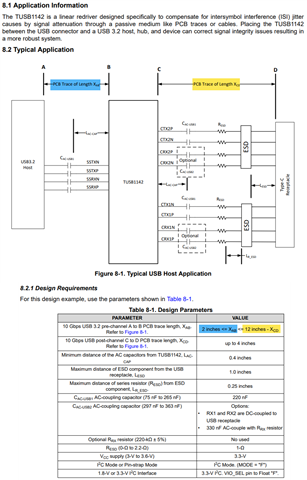

TUSB1142: Host to Receptacle Spacing
Part Number: TUSB1142
In the screenshot captured from the Mux's datasheet, it discusses the distances required for the mux to maintain signal integrity between the Host and USBC Receptacle. Are there any sources of information expanding on this? Like how drastically the integrity of signals is distorted when creating more distance between the Mux and the Host, or if there are ways to extend that distance?
Thanks!
