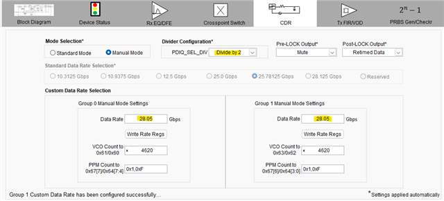

I am evaluating the DS280DF810 retimer using the DS280DF810EVM.
According to the datasheet, the DS280DF810 supports:
  • ÷1: 20.2 – 28.4 Gb/s
  • ÷2: 10.1 – 14.2 Gb/s
  • ÷4: 5.05 – 7.1 Gb/s
Test Result:
  • CDR lock works correctly at 28.05, 26.56, 25.78, 24.33, 13, 12, 11, 10.3125, and 10.3 Gb/s.
  • CDR fails to lock at 14.025 Gb/s, even though this is inside the specified ÷2 band.
Question:
Why does the device fail to achieve CDR lock at 14.025 Gb/s, despite being within the datasheet’s ÷2 lock range?
Any insights would be greatly appreciated.
