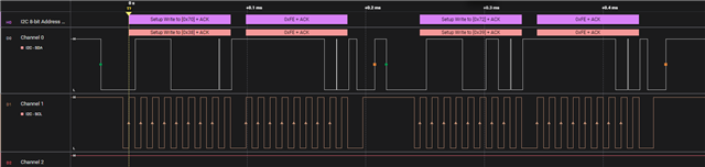

Hello, I am using PCF8574ADWR connected according to the attached diagram. After sending data to the output, there is no data on the outputs, despite the ACK signal. I am attaching the output from the logic analyzer. I have already used 6 pcs from one tape and they all behave the same. When I use the PCF8574N and change the address to the appropriate circuit, everything works correctly.
Can you advise me?
BR and thank you.

  • For a high output, the PCF8547A's output current can be as low as 30 µA. The ULN2803AFWG wants up to 1350 µA at its input.
    You can try to add 820 Ω pull-up resistors at the outputs of the PCF. But it would be a better idea to use an I/O expander with stronger outputs like the TCA9534A and to adjust the software for it.

  • Thank you for your reply.
    I ordered a TCA9534 IC and will write the result after trying the device.
    I think this is the right direction and thank you once again.
  • Hi Vladimir,
    I see Clemens' point about ULN2803AFWG needing up to 1350 uA at its input defined by the following spec in the datasheet:
    However, I don't understand why PCF8574ADWR does not work, but PCF8574N does. The "N" denotes PDIP packaging. The "A" version should have a different I2C address. Other than address and package differences, PCF8574 and PCF8574A should have the same output driving structure. What are the differences between the PCF8574N and PCF8574A circuits?
