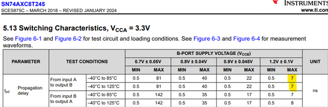

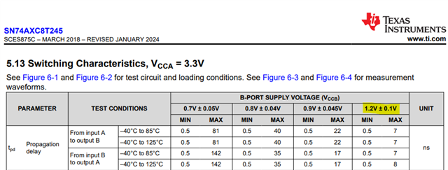

SN74AXC8T245: Level translator for Data Bus
Part Number: SN74AXC8T245
Other Parts Discussed in Thread: SN74AXC4T245, SN74AVC16T245
I am interested in using the SN74AXC8T245 for my 32bit data bus and its associated control lines. My bus runs at 100Mhz. I am considering translation between +3.3V down to between 1.0V to 1.3V. Is this chip fast enough ? Also I am looking for the same type of chip but with 4 bits - do you have anything that will work the same ?
