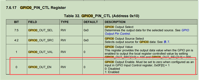

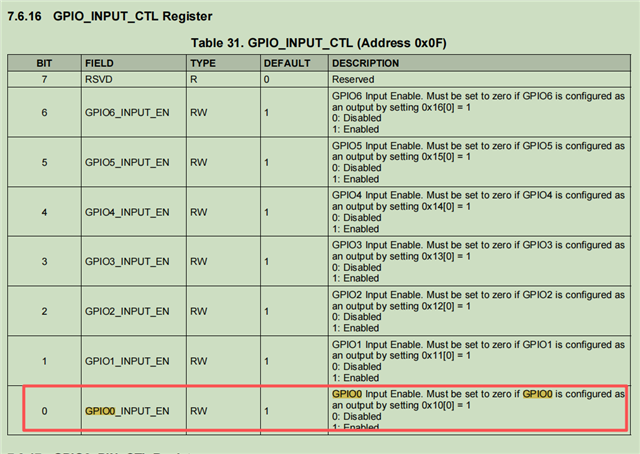

  • For another project. We have followed the previous 954-935 register configuration AON mode, but now the camera will fail to output after working for a period of time.
    By using an oscilloscope for measurement, it was confirmed that the root cause was that GPIO0 of 954 did not output the triggering signal.
    We just need 935 GPIO0 to output 30Hz pulses to sensor,but 954 and 935 output 150Hz pulses.
    Please help review the configuration document and look forward to your response.

  • Hi John,
    It looks like your back channel rate defined in register 0x58 is changing between 0x5E and 0x5A. This will change the back channel rate, and with the frame sync based on the BC clock this can also result in the change in frame sync rate. If you leave the 0x58 setting as 0x5A, the 30Hz frame sync should be seen.
    Thomas
  • Hi Thomas,
    The previous 0x18 register existed before the synchronization signal configuration. I just need to move 0x18 to the front of the synchronous signal configuration. Our camera module has been operating continuously at 85 degrees Celsius for 66 hours without any issues. Thank you very much for your support. It helped us solve the problem.
