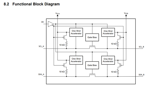

    The TCA9406 has built in one-shot accelerators and 10k PU resistors on both sides of the device. The equivalent PU resistance is 5kohm, adding any external PU resistance only makes this PU resistance value lower (stronger PU to VCC).
    The one-shot accelerators trigger on a rising edge. Once a certain voltage threshold is met, the one-shot triggers which acts like a very strong PU to VCC. You won't be able to adjust the PU strength much by varying the external PU resistance. This is why CLemens has suggested trying a different device that is more passive such as PCA9306 which does not have internal 10k PU resistors, or one-shot accelerators.

    I was referencing external PU resistors. Due to the design of this device, it may not be necessary to add any external PU resistors since they are included within the device.
    Adding external PU resistors would only be necessary if there is significant cap loading on the I2C bus from accumulated trace capacitance and input capacitance from external target and controller devices.
