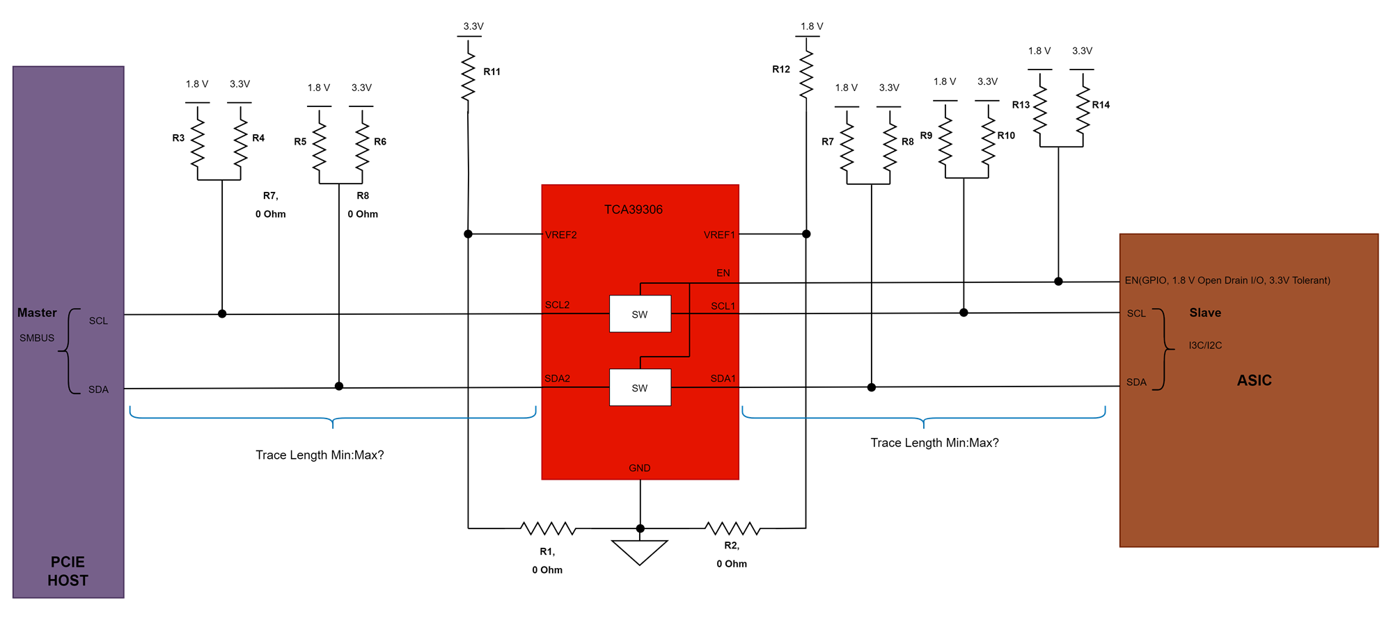

How well is TCA39306 is I3C compatible? MIPI I3C version 1.1 Supported?
Will it work for the implementation? (Attached block diagram)
We need TCA39306 as buffer, will it work?

  • Hi Aswin,
    TCA39306 can level translate I3C signals at 12.5 MHz. It is a purely passive device with no digital, it will not recognize I3C traffic.
    This device will level translate according to the block diagram, but it does not buffer. 1.8V to 3.3V is a valid use case for this device, external PU resistors are required on both sides of the level translator for it to work.

  • Hi Aswin,
    This should work as long as the traces are kept to a minimum and target devices are limited. I3C doesn't have much of a capacitive budget limited to 50pF.

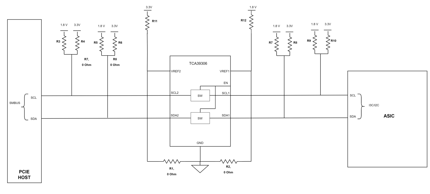

    I will give a complete overview of role of TCA39306 in our circuit, Pls provide your feedback
    Our host SMBUS will support both I3C(1.8V) and I2C(3.3V).
    We want to use TCA39306 in our application (Circuits) as follows:
    1. 1.8 V Switch (I3C)
    2. 3.3 V Switch (I2C)
    3. 3.3 V to 1.8 V translation (1.8 V compatible I2C).

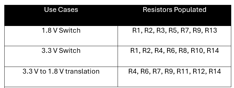

      1. As per TCA39306 data sheet:
        Taking VREF2 =3.3 V, makes VREF1 = 0.85 V to 2.7 V, so we can use TCA39306 for 3.3V(VREF2) to 1.8V(VREF1) translation.
    Below is the block diagram for above use cases, resistors will be populated based on our requirements:
    Based on use cases, Resistors R1-R12 will be populated or not populated. Details mentioned in the diagrams below:
    1. 1.8 V Switch(I3C)
    Here Resistors R1, R2, R3, R5, R7, R9 will be populated, remaining resistors will be NS, making it as a 1.8V I3C switch.
    2. 3.3 Switch (I2C)
    Here Resistors R1, R2, R4, R6, R8, R10 will be populated, remaining will be NS, making this as 3.3V Switch (I2C)
    3. 3.3V to 1.8V translation
    Here resistors R4, R6, R7, R9, R11, R12 will be populated, remaining resistors will be NS, making it as 3.3V to 1.8V translation

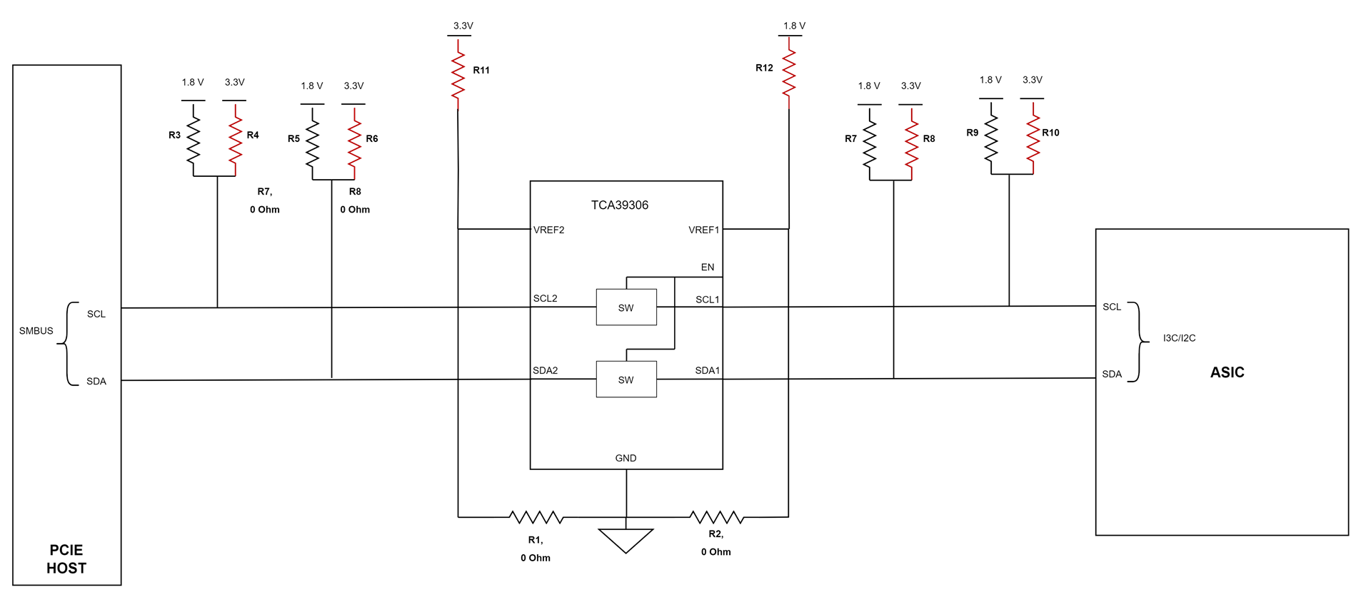

  • Hi Tyler,
    Enable will be controlled by GPIO in ASIC which is 1.8 V Open Drain I/O, 3.3V Tolerant PIN. So based on our use cases we will populate resistors R13,R14 for 1.8V or 3.3V.
    Attached updated block diagram:
    Pls note: Shifted location of VREF1 and VREF2 in TCA39306 for 3.3V to 1.8V translation
                     PCIE Host is Master and ASIC have slave interface.
    Resistors populated for each use cases is given below:

  • Hi Aswin,
    Will this implementation work properly for I3C switching and translation?(Our ASIC is based on MIPI I3C v1.1)
    TCA39306 is compatible to the I3C spec but may not be entirely compliant to the MIPI I3C spec. For example, the PU resistors required on both sides of the level translator are always ON. Therefore in push-pull mode there will be a constant current sink when the nFET pull-down transistor is ON.
    The TCA39306 works for level translating I3C signals, but in not the most efficient way.
    The 1.8V switch use case makes sense.
    The 3.3V switch use case makes sense.

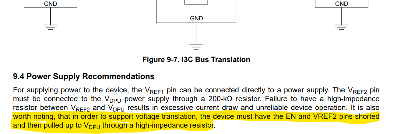

    The 3.3V and 1.8V level translation case will not work. Populating R14 which is the PU resistor to 3.3V means that EN = 3.3V. This sets the gate bias too high. Gate - SCL1 or SDA1 voltage = 3.3V - 1.8V = 1.5V > VTH of the passFET. You create a voltage divider between side 1 and side 2 from the 3.3V supply through the PU resistors, through the passFET, through the PU resistor to 1.8V.
    For the voltage translation case, you would need to follow figure 8-1 which is the normal setup for voltage translation, as the EN+VREF2 pin short automatically sets the EN pin to the proper level translation voltage.
    if you continue in switch mode by biasing the EN pin manually, you would need to use the 1.8V supply. Instead of populating resistor R14, I would recommend populating R13 in the voltage translation case. You will take a hit on propagation delay because the gate voltage is smaller which means Ron is larger, but level translation should work in that case rather than creating a voltage divider between the two supplies.

    As per application example provided in datasheet related to I3C translation, it is mentioned that EN and VREF2 PIns should be shorted, is it required?
    This is not required in the switch mode. If you are following the voltage translation connection example in figure 8-1 of the datasheet, then this is the proper implementation of VREF2+EN short through a 200k PU to VCC2 supply.

  • Hi Tyler,
    So 3.3V to 1.8V  is possible with EN controlled manually is possible with 1.8V supply with propagation delay, right?
    (We cannot short VREF2 and EN because EN should be controlled manually.)
    Aswin
  • Hi Aswin,
    Prop delay will be slightly affected (a few ns). The rise-time on the output side of the TCA39306 will be mostly by the PU resistance. We need to ensure that rise-time for I3C is being met on output side which is a direct result of the PU resistance and trace length on output side.
