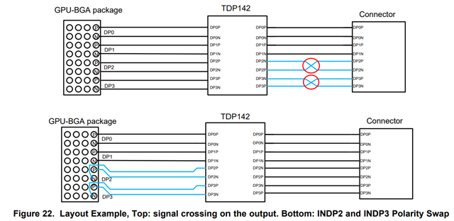

Part Number: TDP142
Hi Team,
I would need some help to understand why is it that the polarity swap for this case is possible?
Does it mean that I can just swap around the other "N" and "P" for the other DP also?
Part Number: TDP142
Hi Team,
You can swap the DP142 polarity on any lanes as long as you maintain the polarity between the input and the output. If you swap the polarity at the input, then you have to swap the polarity at the output as well.
