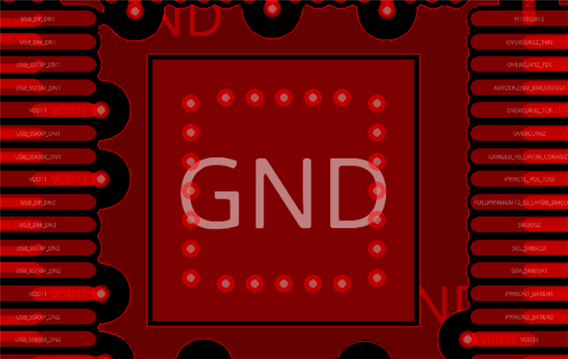

    Sorry let me ask you an additional following question, please.
    My customer is currently experiencing poor soldering on the power pad for this device (occurrence rate: approximately 1%).
    It's possible that solder has flowed into the via, causing insufficient soldering on the thermal pad.
    Is the relationship between the stencil and the stencil opening a possible factor in this defect? ​​
    Also, does the number of vias play a role? The customer used an older datasheet as a reference for their design.
    The number of vias is fewer than in the latest datasheet. (The latest version has 8x8=64 vias, while the customer's design has 6x6=36, with a pin spacing of 1.3mm.)
    Currently, hollow vias are used, but we are considering changing them to filled vias or other options.
    We would also like to consider the relationship between the stencil and the opening, if that is also a factor.
    I would appreciate any advice on this matter.
    Thank you in advance.
    Takumi
  • Let me inform you the additional information about the PCB.
    The PCB is made of FR-4 and is a six-layer board.
    Thanks again!
    Takumi

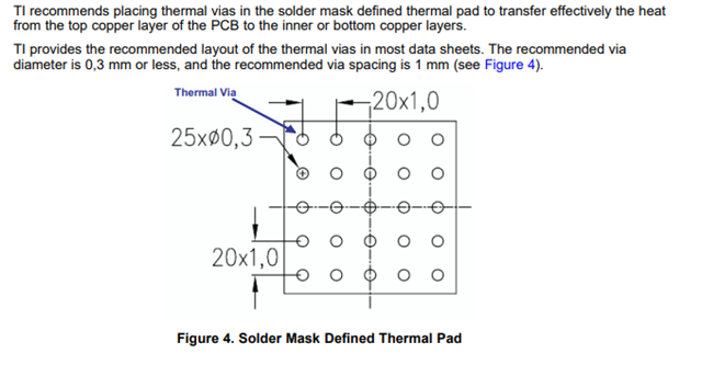

  • Hi Takumi:
      We do recommend PCB layout is the one which is on the datasheet, but not  mandatory .
    The recommended via diameter is 0,3 mm or less, and the recommended via spacing is 1 mm
       Or customer can use example of TUSB4041EVM layout since  it was proving working layout.

  • For stencil  information, please check  section 4.2 of  this document of this document.
    QFN and SON PCB Attachment (Rev. C)
    Best
    Brian

  • Q1) The Vias which datasheet shows are hollow via, correct?
           That is to say, "filled vias" are not mandatory.
    yes
    Q2) The layout data you showed above (Figure 4) : will you tell me the document name?
           The via diameter and space are different from the data datasheet described.
    This is TUSB4041EVM file, I can send to customer if needed.
    Q3) The VIa layout of the EVM is very differnet from the datasheet.
           What is the reason why of this difference?
    The need for vias depends on the amount of power the device dissipates and the Vias in datasheet is not Mandatory.
    Best
    Brian
