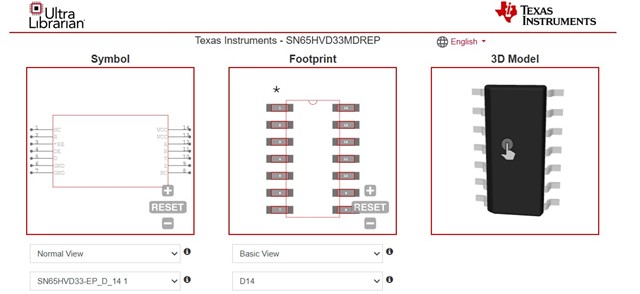

Is it correct that pin 9 of the SN65HVD33MDREP is Y and pin 10 is Z?
Details
Regarding the TI SN65HVD33MDREP.
The datasheet (Revision F, page 3/36) states the following:
9 pin: Y
10 pin: Z
However, the CAD symbol and footprint information in Ultra Librarian state:
9 pin: Z
10 pin: Y
Just to be sure.
The functions of pins 9 and 10 are reversed, but am I correct in understanding that the datasheet is correct?
https://vendor.ultralibrarian.com/TI/embedded/?gpn=SN65HVD33-EP&package=D&pin=14&sid=019907d47fcc0009df9f8b8fef130507d002e07500978&c=1

  • Hi Hiroshi,
    Please use the datasheet values (I also checked the previous versions of the datasheet which also show Y is 9 and Z is 10) . I'm not sure why ultra librarian is referencing the pins backwards but the datasheet should be the correct one to reference.
