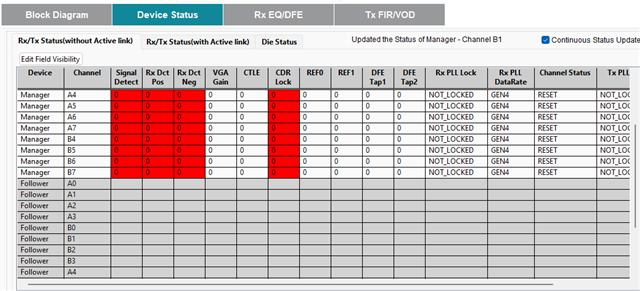

    3. We are currently facing an issue: when installing the graphics card as the end device, it can be detected under Device Manager and the driver installs without issue, but we are unable to scan the eye pattern for the follower device. It always shows CDR unlocked and No Signal. However, when checking the status under the High-Level Page, the follower shows the correct data rate as GEN4, but we are able to scan the eye pattern for the Manager device .

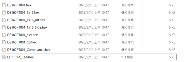

    To make the Gain or EQ work properly, do we only need to write the EEPROM with the provided hex image file?
    Gain and EQ are automatically controlled by the retimer and nothing in the premade EEPROMs that we distribute (I assume you got the file from the DS160PT801_EEPROMImage ZIP folder) will affect them. There is a README file inside the ZIP that has instructions on which EEPROM file to pick based on your link width or other factors. The EEPROM on the EVM may already be flashed with something from the factory, probably the generic DS160PT801.hex, so if you didn't observe any difference that's likely the reason.
    What is the link width of the graphics card? If it is less than x16, then some channels in the retimers will not be used and those will not have any signal. In the High Level Page you can check the status of all channels in both retimers.
    When you want to look at the eye diagram in the Eye Monitor, you should double check the device and channel selections to make sure you are looking somewhere that is supposed to have a signal.

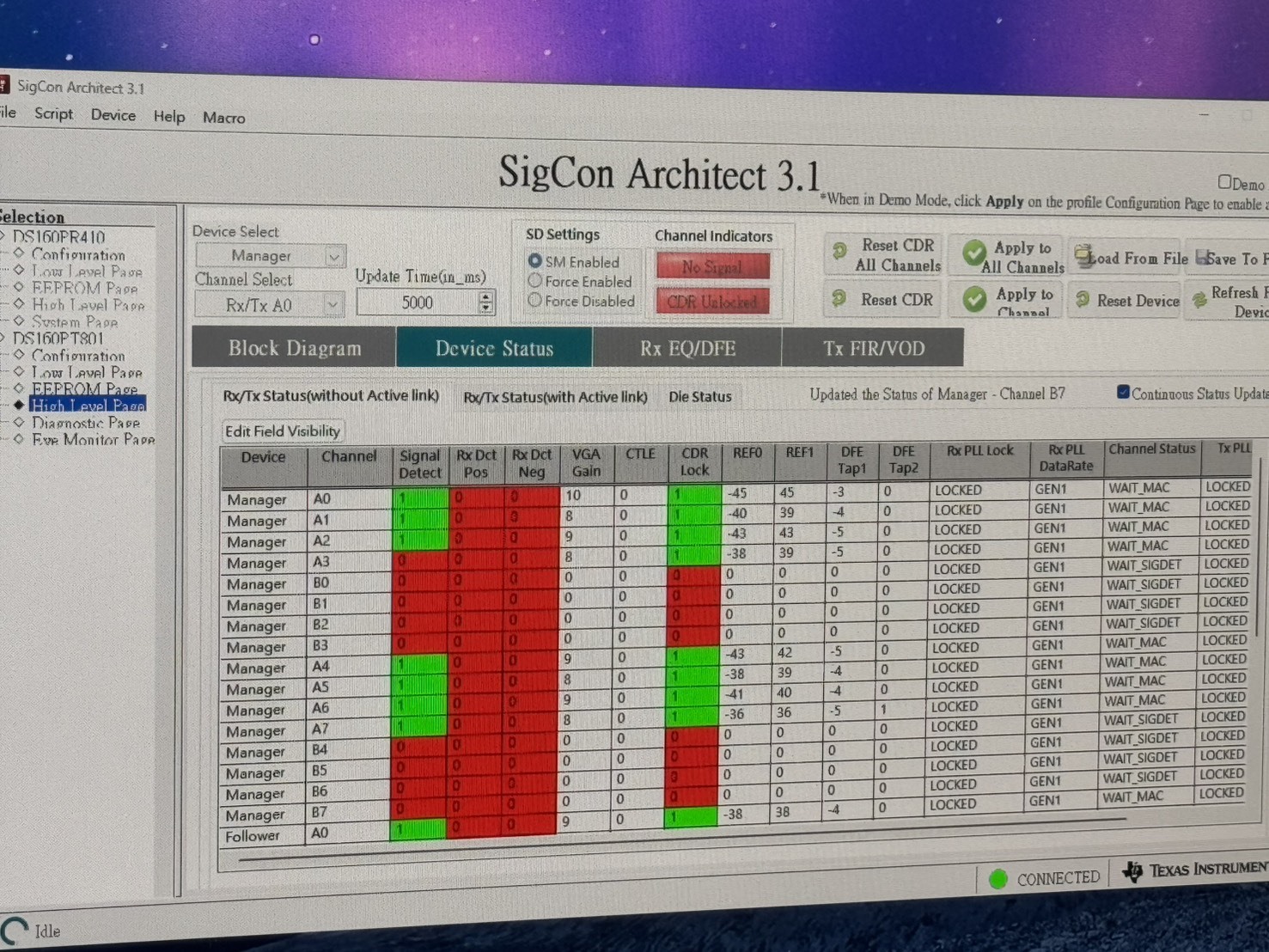

  • Hi Evan ,
    Is it normal that when connecting an end device, such as a PCIe Gen4 x8 graphics card, the device's signal and CDR check are never able to turn green?
  • Hi Ken,
    That looks kind of strange. Channels A0-A3 and B0-B3 in the follower retimer are showing that the PLLs have been locked but they are waiting for signal. It's possible there could have been some activity during startup but the signal and terminations stopped for some reason, or maybe the retimers were expecting a different link width from what actually exists in this setup. Have you checked the PCIe link width of the graphics card to make sure it is linking up in the correct x8 width?
    Evan Su
  • Hi Evan,

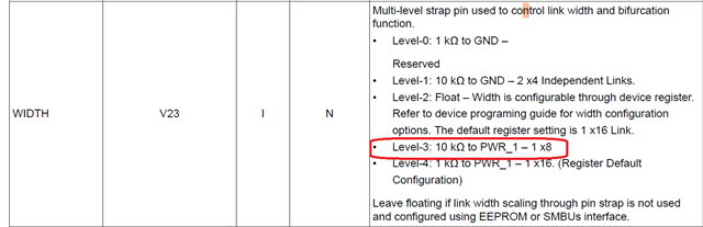

    I have checked with GPU-Z and confirmed that the PCIe link width is running at Gen4 x4, and the EEPROM is using only the basic hex file. It also states that the width is determined by the Width pin (what does this mean?). The EVM board is installed in a PCIe slot that supports Gen5 x16.
    I have checked the EVM datasheet, but it seems there is no description about the J9/14 Width pin header. Currently, it is left floating, which is the default setting that results in the width being set to 4x4.
    I have also noticed that when installing the graphics card with the retimer, especially in PCIe slot 1 controlled by the CPU , the VGA card sometimes fails to pass the POST phase during boot-up, although occasionally it does succeed. When switching to another platform, the issue occurs on both the CPU- and PCH-controlled PCIe slots. However, when testing with a platform using a Core Ultra CPU, everything works fine.
     I have tried setting the PCIe generation to Gen4 or Gen5, enabling Secure Boot, and disabling Fast Boot, but none of these helped. It seems like there may be a link training compatibility issue with the retimer, or perhaps the EEPROM needs to be edited for the startup process. Could it also be related to the follower always waiting for a signal to be received?
    P.S. I have confirmed that with the graphics card attached to both the CPU- and PCH-controlled PCIe slots, I can reboot 20 times consecutively without any issue.

    The WIDTH pin and its settings are explained in the full DS160PT801 datasheet, which is not public on TI.com. Have you requested access to the DS160PT801 secure resources using the link on the DS160PT801 product page?

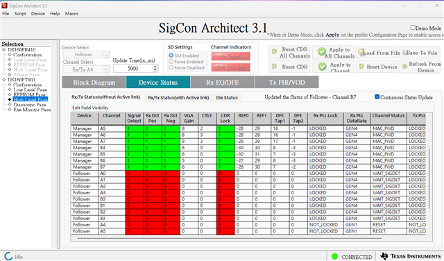

  • Hi Evan,

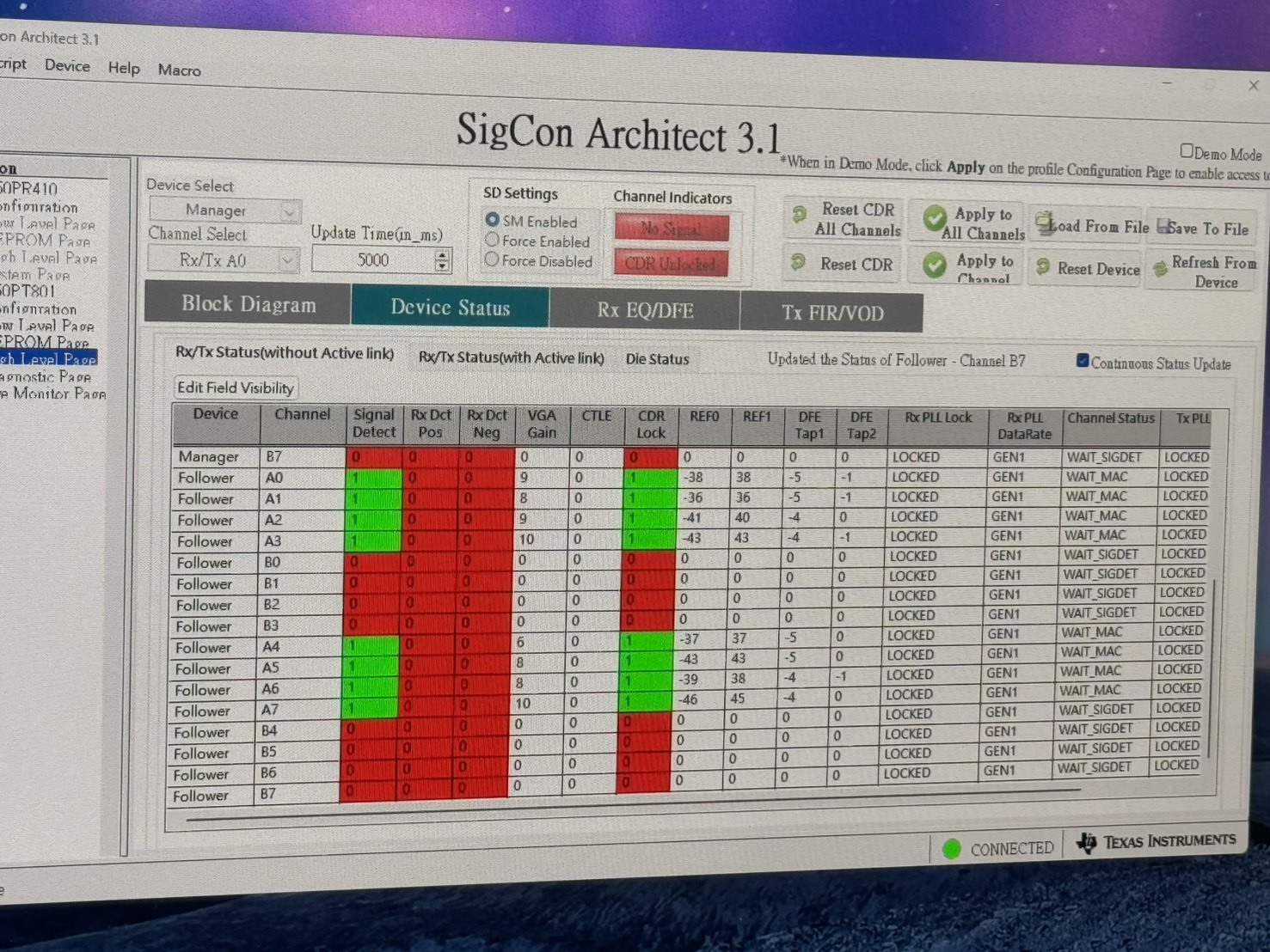

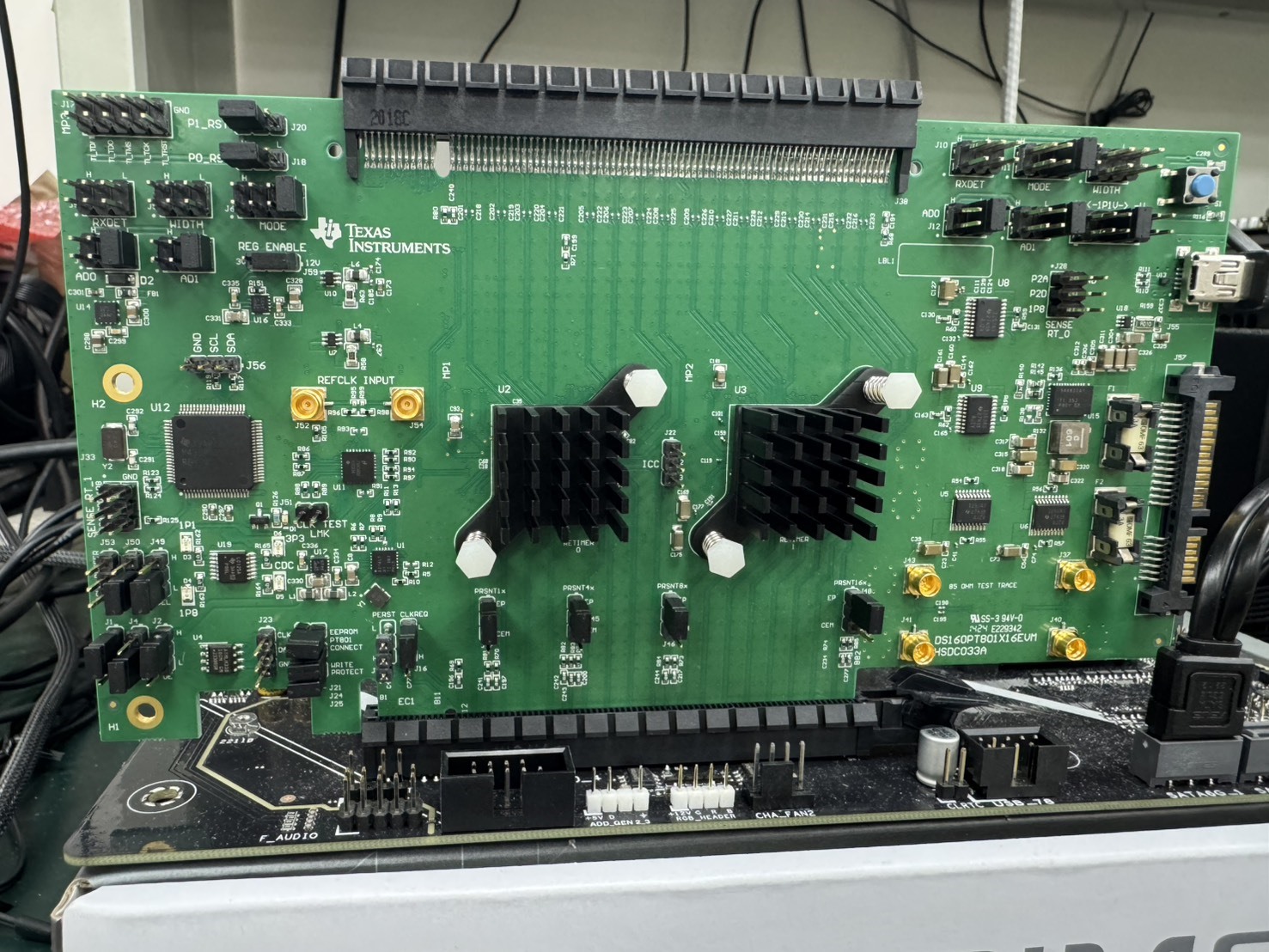

    I and Ken have tried connect J9/J14 WIDTH pin to both pull high to PWR with to 10kohm. But seems can't work.
    1. Some of signal detect still "0", is it normal?
    2. RxPLL datarate only show Gen1, can't run at Gen4 data rate. How to fix it?
    3. For J45–J48, do we need set all floating, only connect J46 pin2-3 for set PRSNT pin to x8?

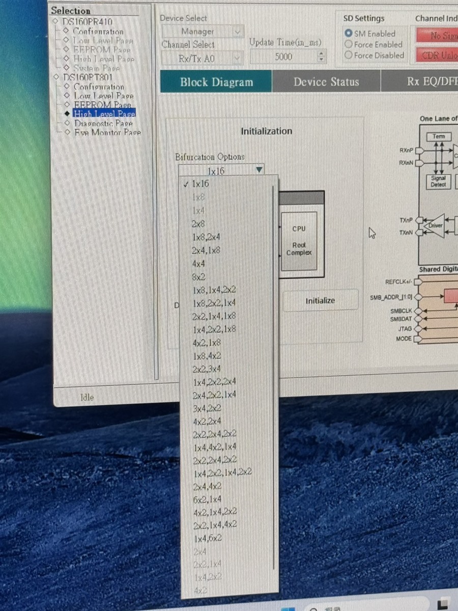

    4. Is there have x8 EEPROM .hex can share to us?
    We can't find 1x8 image in secure resouce folder.
    And also can't choose 1x8 setting in high level page to generate 1x8 EEPROM iamge.
    5. Is there any sample code if we need configurate from BIOS via I2C?
    Thanks!
    Jeff
  • Hi Jeff,
    For #1, if this is a x8 card, this is expected since there are 8 lanes detected and connected.
    #2: Is this at POST or in windows?  Before the system enters Windows a Gen1 may be expected.
    #3: Default configuration of 1-2 can be used for these jumpers.
    #4: The DS160PT801.hex image should set the link width based on WIDTH pin state.
    #5: I'm not aware of any example code, I am verifying this.
