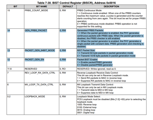

We currently have some issues with your Ethernet PHY DP83867IR and trying to troubleshoot it. And as it is hardly possible to measure the signals under the SoC for the RX lines, I would like to try to use the internal self test. I also found your APN for that, which roughly explains what to need to be done.
And here is my question: Is there an APN which actually explains how this is done in form of an example? Like what commands do I need to send, to the PHY? How do I check that the receiving packets are the same? Or can I just do an iperf command on myself?

    In terms of rise/fall time, DP83867 has MAC impedance control on 0x0170 which has been known to help with rise/fall time issues.You can change the value on this to change rise/fall time on the RGMII lines.
    In addition, if you have another board with 867, you can also enable PRBS packet generation from the 867 and then send packets into the problematic board. This data will be sent to the RGMII RX line at least so you can probe the RX lines of RGMII at least.
    You can enable bits 12, 13, 14 to 1 to generate 64 bytes continuous PRBS packets to its link partner.
    You can generate PRBS packets with length of 64 or 1518 bytes. I know you would like to test both TX and RX RGMII lines, so this may not be the most sufficient method for you. However, I hope that this can help you with probing the RX lines more easily.

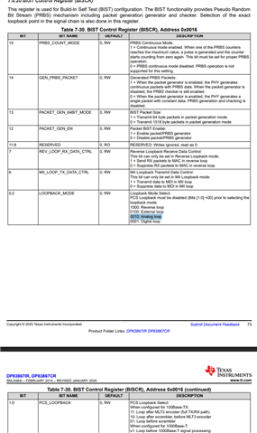

    We had internal discussion on this and we are thinking that if you put the PHY in analog loopback and then generate PRBS data from the same PHY, this may be able to loop the data back into RGMII RX line.
    If this doesn't work, you would have to use a loopback cable to send the PRBS data back into RGMII RX line. Otherwise, the best solution would be the one I suggested above. Even though you are introducing additional variable, the above method will definitely be able to send data into RGMII RX line.
    You can generate PRBS data as I mentioned in the previous post. You can set the PHY in analog loopback by setting bits 5:2 on reg 0x0016 as 0010 and bit 1:0 of the same register to 00.
