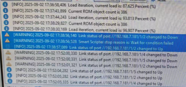

    >Are we certain that the link is really down, or is there just no data being transmitted? Does the PHY respond normally to register reads during the "link down" time?
    The link partner (upper tester )upper tester  shows the link down information in its log.link down log
    Currently, we have performed RFC2889 performance test around 3 times and observed this issue once. We will keep testing and feedback you.

  • Hi Jian,
    OK, this is interesting. I am reviewing with my team but in the meantime I suggest you check the registers from the PHY if possible. Is there a way to halt the test when the link is down?
    Evan Su
  • Hi Evan,
    I think there is no way to halt the test when the link is down.
    We performed test again yesterday but didn't observe this issue.
    Maybe this issue is not caused by the PHY?
    We will continue testing and feedback you in case this issue can be reproduced.
