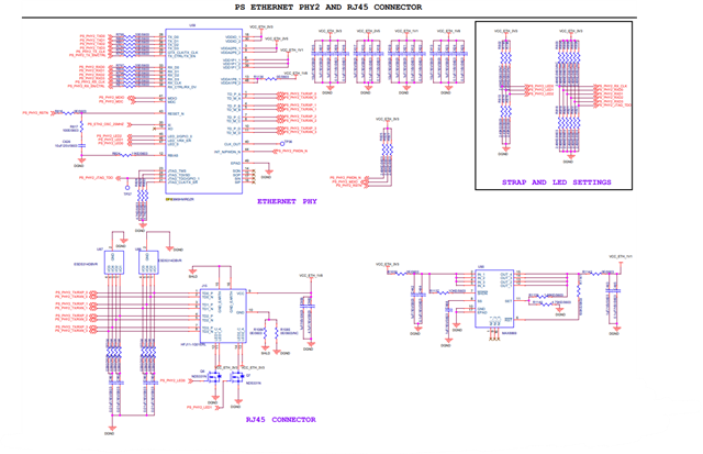

In Our case we are using DP83869 PHY for 1000 Base-TX RGMII, Does it supports 1000 Base -TX or not.?
We are able to operate/communicate with the 100Mbps speed but while operating with 1000Mbps its not responding/communicating. Suggest the what will be the cause and Schematics are attached for your reference review and suggest if any modifications are required.
What is the type and the length of the cable you are using? Have you tried writing 1D5h = 0xF508?
