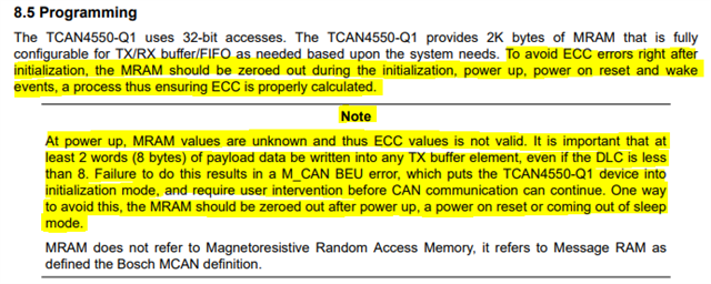

    It sounds like you are getting a uncorrected ECC error that is causing the device to re-enter initialization mode (setting the INIT bit of the Control register 0x1018[0] = 1) and stops CAN communication resulting in your CAN Silent error which is then causing the CAN Error and Global Error bits to be set.
    The MRAM cells are not automatically initialized to "0" at power up or following a reset, but the ECC calculations assume all unused bits have a value of "0."  If you are not initializing the buffer cells to zero as part of your configuration sequence, then you will need to make sure to write zeros to any unused bytes in the MRAM elements such as the TX buffers to prevent possible ECC errors.

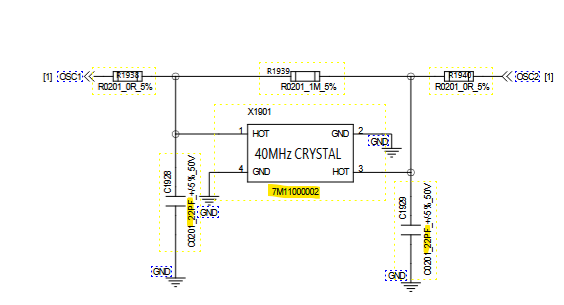

    Please also check if this schematic diagram is correct. If any modifications are needed, please explain it in detail

    I'm not sure what value you are using for TXB_ELEMENT_SIZE, but if it is not 18 then you may not be completely initializing all of the allocated MRAM to zero based on my understanding of your initialization sequence.  A TX Buffer Element has 2 header words (8 bytes) + the number of bytes allocated from the TX Buffer Data Field Size register (TBDS in register 0x10C8[2:0]).  Currently you have a 64 byte data field which is 16 words.
    If you are by chance using 16 or 18 for the TXB_ELEMENT_SIZE to verify if you are possibly not initializing all of the TX Buffer/FIFO memory.
    From your configuration, it appears you are using about 97% of your MRAM and you only have 16 words of unused MRAM that is not being initialized.  I would recommend to initialize all MRAM (0x8000 to 0x87FF) to ensure there is no chance of accessing memory that has not been initialized to zero and take away that possible reason for an ECC error.

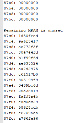

    From your datalog, I see that MRAM cells 0x87C0 to 0x87FF are random values that have not been initialized.  Please try to initialize these bytes and see if this resolves your ECC errors.

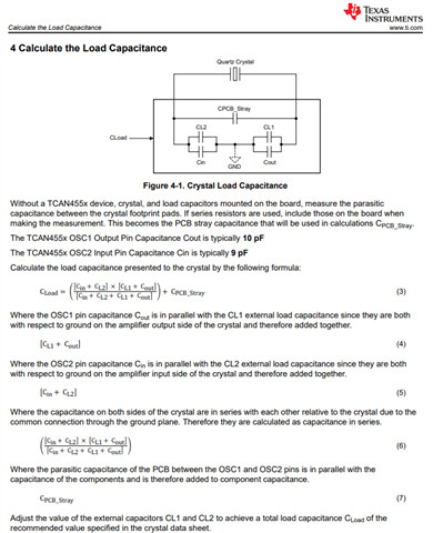

    From the schematic, it overall looked OK. I don't know what the crystal's load capacitance requirements are, but 22pF caps for OSC1 and OSC2 are about twice the value I normally see for 40MHz crystals.  Because the crystal is directly used by the MCAN controller and the Digital Core, any disruptions to this clock can also cause SPI and CAN communication errors.  In general if the crystal circuit is not optimized, it may fail to start oscillating, stop oscillating, or have disruptions by switching between single-ended clock mode and crystal mode if the oscillation voltage drops below 150mV on OSC2.
    Please also review the TCAN455x Clock Optimization and Design Guidelines Application Report (Link) for more information.

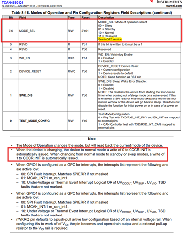

  • Can you first read the MODE_SEL field of the Modes of Operation and Pin Configuration register (0x0800[7:6]) to verify the device is in Normal mode an is NOT in Standby Mode?
    If the device is in Standby Mode, then the INIT bit in the CCCR register (0x1018[0]) will be set to '1' and your initialization will fail.

    6076.1(6).txt1.After reviewing multiple failed register dumps, as shown in the attachment, 0x1018 [0] is always 0
    2.The introduction of 0x0800 [7:6] cannot be found in the specification sheet. Please provide it.
    3.Can we confirm from the current phenomenon and regdump whether it is a software related issue or a hardware issue?
    4.How should we analyze next?
  • 4370.1(4).txt7103.regdump.txt
    5.What waveforms of signals are needed to confirm that there are no hardware issues?
  • <4>[ 2.719212] .(3)[1:swapper/0]tcan4x5x spi3.0 (unnamed net_device) (uninitialized): Failed to init module
    1.May I ask what happened to this error? How to solve it?
  • The driver code related to CAN has been provided, please help to check if there are any issues.m_can.rar
  • 最新的regdump如附件,请帮忙看看。

    85e0: 00000000
    85e4: 00000000
    85e8: 00000000
    85ec: 00000000
    85f0: 00000000
    85f4: 00000000
    85f8: 00000000
    85fc: 00000000
    8600: 00000000
    8604: 00000000
    8608: 00000000
    860c: 00000000
    8610: 1f7c0000
    8614: 01880000
    8618: 550c0102
    861c: 55555555
    8620: 00000000
    8624: 00000000
    8628: 00000000
    862c: 00000000
    8630: 00000000
    8634: 00000000
    8638: 00000000
    863c: 00000000
    8640: 00000000
    8644: 00000000
    8648: 00000000
    864c: 00000000
    8650: 00000000
    8654: 00000000
    8658: 1f7c0000
    865c: 02880000
    8660: 550d0102
    8664: 55555555
    8668: 00000000
    866c: 00000000
    8670: 00000000
    8674: 00000000
    8678: 00000000
    867c: 00000000
    8680: 00000000
    8684: 00000000
    8688: 00000000
    868c: 00000000
    8690: 00000000
    8694: 00000000
    8698: 00000000
    869c: 00000000
    86a0: 1f7c0000
    86a4: 03880000
    86a8: 550c0102
    86ac: 55555555
    86b0: 00000000
    86b4: 00000000
    86b8: 00000000
    86bc: 00000000
    86c0: 00000000
    86c4: 00000000
    86c8: 00000000
    86cc: 00000000
    86d0: 00000000
    86d4: 00000000
    86d8: 00000000
    86dc: 00000000
    86e0: 00000000
    86e4: 00000000
    86e8: 1f7c0000
    86ec: 04880000
    86f0: 550c0102
    86f4: 55555555
    86f8: 00000000
    86fc: 00000000
    8700: 00000000
    8704: 00000000
    8708: 00000000
    870c: 00000000
    8710: 00000000
    8714: 00000000
    8718: 00000000
    871c: 00000000
    8720: 00000000
    8724: 00000000
    8728: 00000000
    872c: 00000000
    8730: 00000000
    8734: 00000000
    8738: 00000000
    873c: 00000000
    8740: 00000000
    8744: 00000000
    8748: 00000000
    874c: 00000000
    8750: 00000000
    8754: 00000000
    8758: 00000000
    875c: 00000000
    8760: 00000000
    8764: 00000000
    8768: 00000000
    876c: 00000000
    8770: 00000000
    8774: 00000000
    8778: 00000000
    877c: 00000000
    8780: 00000000
    8784: 00000000
    8788: 00000000
    878c: 00000000
    8790: 00000000
    8794: 00000000
    8798: 00000000
    879c: 00000000
    87a0: 00000000
    87a4: 00000000
    87a8: 00000000
    87ac: 00000000
    87b0: 00000000
    87b4: 00000000
    87b8: 00000000
    87bc: 00000000
    87c0: 00000000
    87c4: 00000000
    87c8: 00000000
    87cc: 00000000
    87d0: 00000000
    87d4: 00000000
    87d8: 00000000
    87dc: 00000000
    87e0: 00000000
    87e4: 00000000
    87e8: 00000000
    87ec: 00000000
    87f0: 00000000
    87f4: 00000000
    87f8: 00000000
    87fc: 00000000
  • Hi Wang,
    You can find this information in the datasheet.
    I don't see an explanation in the software configuration, or the interrupts of the device.  I see the PEA bit is set indicating a message had a protocol error during the Arbitration phase, but the error counters are all zero, and the protocol status register doesn't indicate the device is in a warning or bus off condition.  So it is likely not the reason for the device to stop communicating.
    What I do see is that the TX FIFO is completely empty and there are no messages loaded for transmission.  If the original complaint is still that there is no response from this device after a message is sent to it, then I would expect there to be a message loaded into the TX FIFO pending transmission, or the device would have been disabled due to excessive errors.
    I can't at the moment say there is anything functionally wrong with the configuration of this device, or with the hardware and that my current interpretation of information you have provided points to a issue loading messages into the TX FIFO for transmission.
    When your CAN Silent or No Response condition occurs, can you verify the MCU has loaded a message into the TX FIFO and has written to the TX Buffer Add Request (TXBAR) register (0x10D8) setting a "1" to the appropriate TX FIFO element used for the message?
    The TX FIFO Free Level is set to 5, which is also equal to the TX FIFO Size meaning it is completely empty.  The TX Buffer Request Pending register (0x10CC) also is 0x0, meaning there are no TX messages pending transmission.
    I suspect the error may be software related and the MCU has stopped loading messages into the TX FIFO resulting in your CAN Silence error.
    Jonathan

    On several occasions in my previous posts I have brought up the clock circuit and crystal capacitor values.  I have not seen a response, to those comments, but I need you to verify the crystal circuit is optimized properly and providing a stable clock.  Most SPI and CAN errors such as this that are not related to the register configuration are generally the result of an unstable clock.
    From your schematic I see a crystal part number of "7M11000002" and 22pF capacitor values.  Searching for information on "7M11000002" I only see references for crystals with that part number that have a total load capacitance of 12pF.
    Can you verify the total load capacitance requirements for your particular crystal?  Using an estimate of 3pF of PCB capacitance along with the 22pF load caps, I calculate an approximate total load capacitance on your crystal of 18.75pF.  If the load capacitors are too large, it can cause the oscillations to stop or fail to start.  These disruptions can also be intermittent and vary with other conditions such as temperature which causes a shift in the amount of parasitic capacitance.
    Please review the TCAN455x Clock Optimization and Design Guidelines Application Report (Link).
    If your crystal has a lower clock capacitance specification, can you adjust value of the capacitors on your board and see if there is any change to your test results by making the failure more or less frequent?
    Jonathan
