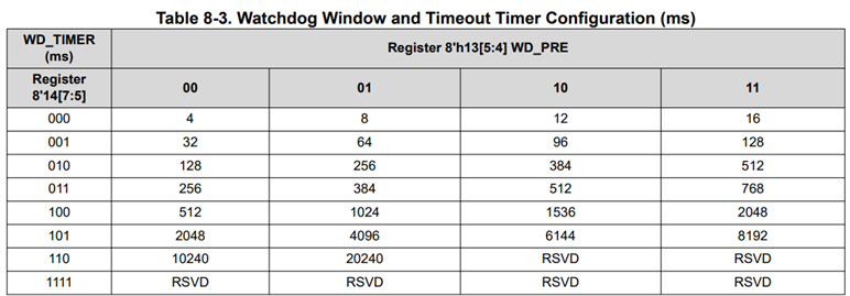

2)Whether the below listed values in the below table for SPI is total window time? For example, if we choose WD_TIMER as 000 and WD_PRE as 11, then chosen total window
time is 16ms?

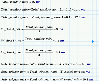

3)Then whether watchdog has to be serviced with 5.6ms to 10.4ms for 16ms window selection?
Calculation:

    2. Yes.
    3. No, please see 8.3.22.10.7 of the data sheet as the 8.8 ms after the window starts and the latest safe time as 14.4 ms.
