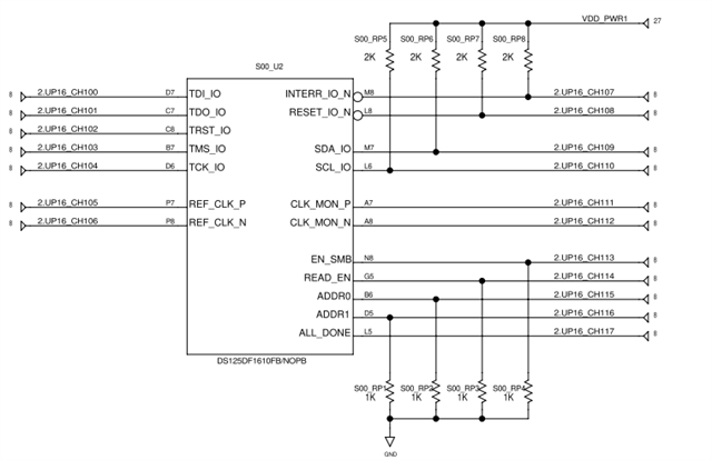

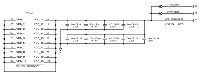

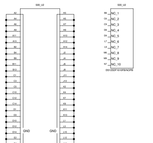

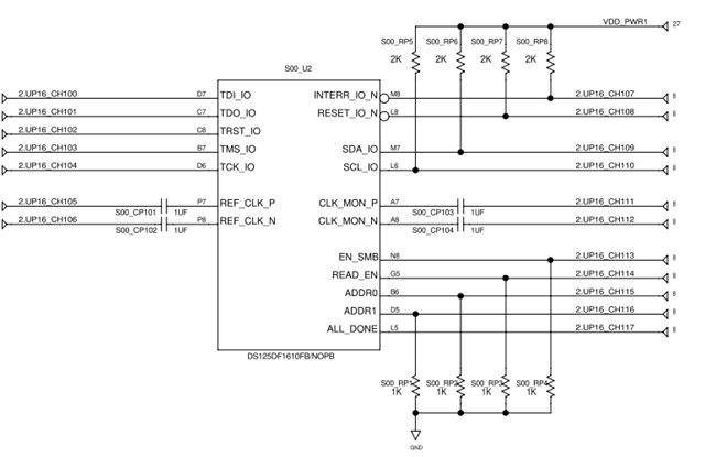

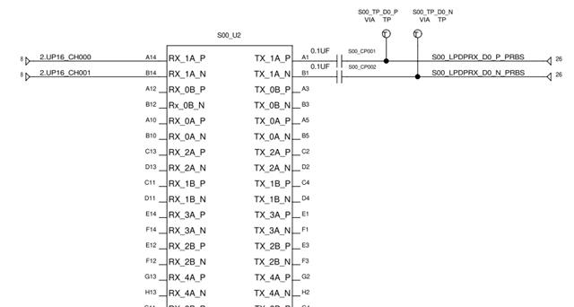

Hi TI teams
We plan to adopt the DS125DF1610FB in this project design. Could you kindly review the following circuit connections of the DS125DF1610 and advise whether any modifications are recommended?
Please note that UP16_CH refers to the channel on the ATE, and the PRBS signal will operate at 3 Gbps.
