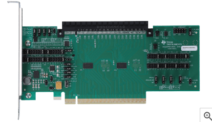

Hi Team,
Can I use this EVM to test PCIe x1 lane?
    You can test x1 lane on this EVM. You just need to plug x1 lane device on this EVM instead of x16 lane device.
    J
  • Hi Nachiketh,
    The EVM has a x16 CEM connector on top and a x16 gold finger interface on the bottom. It is possible to plug a PCIe x1 endpoint with a gold finger interface into the EVM's CEM connector. It is not possible to plug the EVM into a baseboard with a physical PCIe x1 CEM connector because the x16 gold finger would be too wide.
