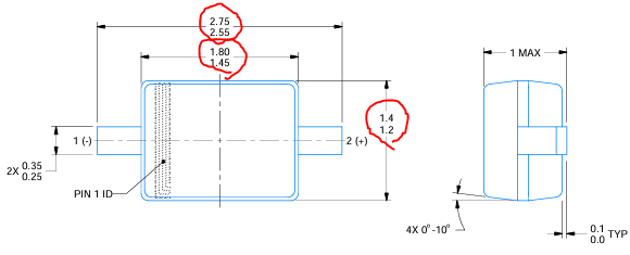

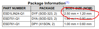

According to the package information table on page 1 of the datasheet, the ESD1LIN24-Q1 is 2.5mm x 1.2mm.
However, when looking at the package outline on page 23 of the same datasheet, the NOM value and dimensions do not appear to match.
There is a discrepancy between the package information table and the package outline, so please correct it.

  • Hi Junji,
    This nominal value for the body size should be 2.65mm x 1.3mm, as indicated by the package drawing. This should be updated in the Package Information table in the next 2-3 weeks. Thank you for sharing this!
