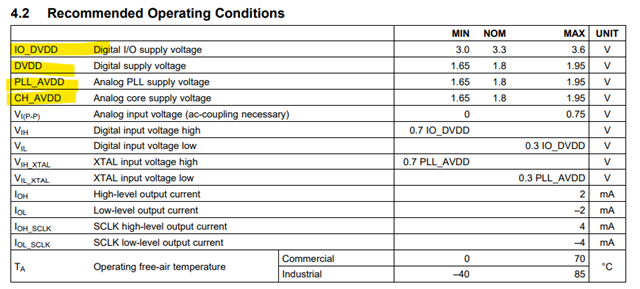

TVP5150AM1: Power up and power down sequence for TVP5150AM1IPBS
Part Number: TVP5150AM1
Hi Team,
TVP5150AM1IPBS video decoder part required 1.8V and 3.3V for its operation.
Is there any power up sequence required for 1.8V and 3.3V, which voltage should come first or is it fine to power on any voltage first.
Similarly is there any power down requirement.
