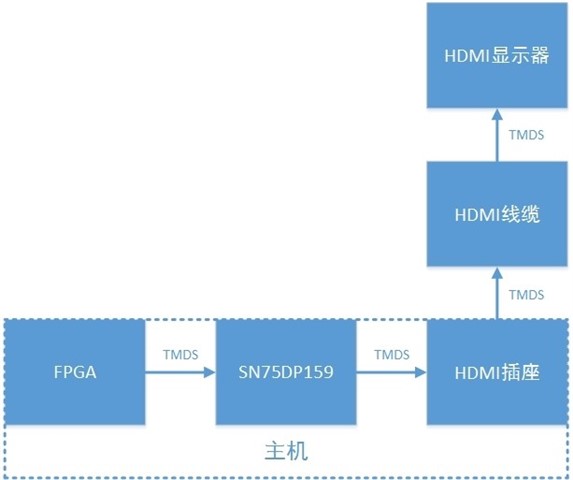

    My customer are currently experiencing the problem: Sony and LG brand 4K display occasionally show black screen 1 to 2 seconds after recovery normal. For LG display test , customer have detected a tmds character error through the SCDC register specified by the HDMI protocol.
    Customer need to confirm if the link from FPGA to DP159 or DP159 to Monitor is experiencing an error, so the following needs require we to provide the relevant register table and configuration process:
    A. Customer need a method always monitor TMDS disparity or data errors (do not use USB-to-i2c to debug DP159) without breaking down their product during normal use. Are there other statuses that can indicate if there is an error in the transmitted data?
    B.The eye scan tool needs to be tested to confirm signal quality, possibly adjusting the signal from the FPGA output, and also monitoring the FPGA to DP159 link for sign errors to confirm proper parameters. For the initial verification step of a single machine, customer can use the USB to iic tool first, and then they want to integrate the eye scan test function into our device. Is this possible?
    The following is a hardware link diagram:
