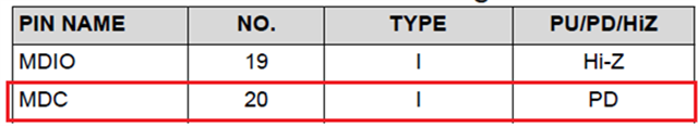

Regarding DP83822, my customer understands that the internal pull-down (PD) resistor functions during reset, as shown in datasheet Table 6-2.
However, the internal PD resistor does *not* function after reset is deasserted, as shown in Table 6-1. Is this correct?

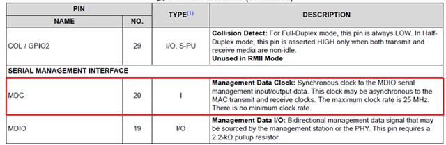

If an internal resistor were active, my customer would expect to see an “S-PU” description like COL pin.
Since there is no such description on the MDC pin, my customer assumes there is no internal PD during normal operation after reset is deasserted.
