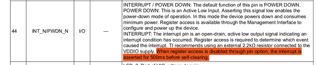

How to confirm if the PHY interrupt handler is invoked and serviced the interrupt (By reading the ISR register right)?
When reading the ISR register manually or in interrupt handler function after sometime it reads 0x0.
Please help in debugging why the interrupt remains low and not de-asserted.
    PHY interrupt is serviced by reading the ISR register. This register will clear on read so you can only read it once and should deassert the interrupt once the register is read.
    However, the interrupt can also self-clear if the register hasn't been read for 500ms in case the user doesn't have register access. This could be the reason why the interrupt handler function sometimes read 0x0. Lastly, once the interrupt is triggered, new interrupts are not routed until the current interrupt is cleared. This can be the reason why the interrupt is not being deasserted. If new interrupts are constantly being triggered, the interrupt will never seem to be clearing.
    Have you tried enabling only one interrupt event and see if this event persists?
    J
  • Hello J,
    Thanks for your reply.
    Bowya: OK. The register is read once in handler function as below. So it should be enough to clear the register.
    Bowya: How to know when the register access is not there? Even when register access is there, self-clear option also is applicable and valid? In datasheet, it says through pin option if register access is disabled then pin option, then 500ms self clearing.
    Lastly, once the interrupt is triggered, new interrupts are not routed until the current interrupt is cleared. This can be the reason why the interrupt is not being deasserted. If new interrupts are constantly being triggered, the interrupt will never seem to be clearing. Have you tried enabling only one interrupt event and see if this event persists?
    Bowya: Yes, I have tried with single interrupt enabled as well. The log & source attached. Please check and give your assistance.

  • Hi Bowya,
    We discussed this internally and the description in the datasheet is misleading. As there is no pin option to disable register access, please understand this as if the interrupt register is not read for 500ms, the interrupt self-clears.
    I looked at the log and the code and this is an interesting situation.
    Have you tried enabling the interrupt pin, but do not enable any of the interrupt masks? I wonder if the interrupt pin is still being asserted. If so, I would like to check your board design to see if there's any hardware issue.
    J
  • Hi J,
    Without enabling any interrupts masks also, the interrupt pin is being asserted. The ISR register when manually reading 6th and 12th bit are set. Below is code for not enabling any interrupt source and log also attached.

  • Hi Bowya,
    Interrupt flags on the register will still go up even if the mask is disabled. Only the interrupts with the mask enabled will route to the interrupt pin.
    As the interrupt pin goes low even when there is no mask routed to the interrupt pin, I am suspecting if there is a hardware issue when the cable is connected.
    Could you send me the schematic so we can look if there are any hardware issues? I sent you a friend request so feel free to message me the schematic.
    In addition, could you check the polarity of the INT pin? The default should be active low, but the driver initialization may have set it to active high.
    Please check register 14h bit 13.
    J
  • Hi J,
    I have sent the schematic screenshot and GEN_CFG2 register read. Please check and give your suggestions.
    Thank you,
    Bowya
  • Hi Bowya,

    [   20.987948]
    [   20.987948] Enable Interrupt output INT_OE in CFG4 register in dp83869_config_init
    [   20.997937]
    [   20.997937] DP83869_CFG4 bit7:1
    [   21.003750]
    [   21.003750] Enable Interrupt output INT_OE in CFG4 register in dp83869_config_init
    [   21.013165]
    [   21.013165] DP83869_CFG4 bit7:1
    [   21.018529]
    [   21.018529] Phy interrupt config_intr link down condition in dp83869_config_intr: Micr_value:0       Ficr_value:0
    [   21.029935]
    [   21.029935] Interrupt occured reading MII_DP83869_ISR : 0    DP83869_FX_INT_STS : 17476
    [   21.039251] macb ff0c0000.ethernet eth0: PHY [ff0c0000.ethernet-ffffffff:01] driver [TI DP83869] (irq=52)
    [   21.039983]
    [   21.039983] Phy interrupt enabled link up condition in dp83869_config_intr
    [  OK  ] Reached target Network.
    [   21.057908]
    [   21.057908] Interrupt occured reading MII_DP83869_ISR : 0    DP83869_FX_INT_STS : 17476
    [   21.072402]
    [   21.072402] MICR value default:0     FICR value default:0, dp83869_config_intr
    [   21.080918]
    [   21.080918] MICR value:0, dp83869_config_intr
    [   21.086816]
    [   21.086816] FICR value:0, dp83869_config_intr
    [   21.092670] macb ff0c0000.ethernet eth0: configuring for phy/rgmii-id link mode
    [   21.104758] pps pps0: new PPS source ptp0
    [   21.111799] macb ff0c0000.ethernet: gem-ptp-timer ptp clock registered.
             Starting Permit User Sessions...
             Starting Target Communication Framework agent...
    [  OK  ] Finished Permit User Sessions.
    [  OK  ] Started Getty on tty1.
    [  OK  ] Started Serial Getty on ttyPS0.
    [  OK  ] Reached target Login Prompts.
    [  OK  ] Started Target Communication Framework agent.
    [   21.298761]
    [   21.298761] Phy interrupt config_intr link down condition in dp83869_config_intr: Micr_value:0       Ficr_value:0
    [  OK  ] Reached target Multi-User System[   21.316327]
    [   21.316327] Interrupt occured reading MII_DP83869_ISR : 0    DP83869_FX_INT_STS : 17476
    [   21.331291] macb ff0d0000.ethernet eth1: PHY [ff0e0000.ethernet-ffffffff:0f] driver [TI DP83869] (irq=POLL)
    [   21.341088] macb ff0d0000.ethernet eth1: configuring for phy/sgmii link mode
    [   21.350163] pps pps1: new PPS source ptp1
    [   21.357126] macb ff0d0000.ethernet: gem-ptp-timer ptp clock registered.
    [   21.372966]
    [   21.372966] Phy interrupt config_intr link down condition in dp83869_config_intr: Micr_value:0       Ficr_value:0
    [   21.384488]
    [   21.384488] Interrupt occured reading MII_DP83869_ISR : 0    DP83869_FX_INT_STS : 17476
    [   21.384561] macb ff0e0000.ethernet eth2: PHY [ff0e0000.ethernet-ffffffff:03] driver [TI DP83869] (irq=POLL)
    [   21.384581] macb ff0e0000.ethernet eth2: configuring for phy/sgmii link mode
    [   21.388104] pps pps2: new PPS source ptp2
    [   21.421322] macb ff0e0000.ethernet: gem-ptp-timer ptp clock registered.
    [  OK  ] Finished Record Runlevel Change in UTMP.
    [  OK  ] Finished OpenSSH Key Generation.
    zynqmp login: root (automatic login)
    [   23.793890] audit: type=1006 audit(1709054776.044:2): pid=750 uid=0 old-auid=4294967295 auid=0 tty=(none) old-ses=4294967295 ses=1 res=1
    [   23.806219] audit: type=1300 audit(1709054776.044:2): arch=c00000b7 syscall=64 success=yes exit=1 a0=8 a1=ffffc85aab00 a2=1 a3=1 items=0 ppid=1 pid=750 auid=0 uid=0 gid=0 euid=0 suid=0 fsuid=0 egid=0 sgid=0 )
    [   23.832703] audit: type=1327 audit(1709054776.044:2): proctitle="(systemd)"
    root@zynqmp:~# [   31.353944] irq 52: nobody cared (try booting with the "irqpoll" option)
    [   31.360653] CPU: 0 PID: 0 Comm: swapper/0 Not tainted 6.6.40-xilinx-g0053546d7314 #1
    [   31.368399] Hardware name: xlnx,zynqmp (DT)
    [   31.372574] Call trace:
    [   31.375013]  dump_backtrace+0x90/0xe8
    [   31.378693]  show_stack+0x18/0x24
    [   31.382009]  dump_stack_lvl+0x48/0x60
    [   31.385671]  dump_stack+0x18/0x24
    [   31.388987]  __report_bad_irq+0x38/0x120
    [   31.392910]  note_interrupt+0x310/0x360
    [   31.396747]  handle_irq_event+0xd8/0xe8
    [   31.400584]  handle_fasteoi_irq+0xb0/0x284
    [   31.404681]  generic_handle_domain_irq+0x2c/0x44
    [   31.409307]  zynq_gpio_irqhandler+0xa0/0x16c
    [   31.413578]  generic_handle_domain_irq+0x2c/0x44
    [   31.418204]  gic_handle_irq+0x6c/0x9c
    [   31.421867]  call_on_irq_stack+0x24/0x4c
    [   31.425790]  do_interrupt_handler+0x80/0x84
    [   31.429974]  el1_interrupt+0x34/0x54
    [   31.433550]  el1h_64_irq_handler+0x18/0x24
    [   31.437647]  el1h_64_irq+0x64/0x68
    [   31.441050]  default_idle_call+0x28/0x3c
    [   31.444973]  do_idle+0xac/0x100
    [   31.448115]  cpu_startup_entry+0x34/0x3c
    [   31.452038]  kernel_init+0x0/0x1e0
    [   31.455441]  arch_post_acpi_subsys_init+0x0/0x8
    [   31.459972]  start_kernel+0x504/0x60c
    [   31.463635]  __primary_switched+0xbc/0xc4
    [   31.467646] handlers:
    [   31.469911] [<00000000daddee39>] irq_default_primary_handler threaded [<00000000ea6d12c5>] phy_interrupt
    [   31.479416] Disabling IRQ #52

    One question: Before the PHY configures interrupt, why is the signal low? This pin is power down by default so this should be high. If not, the PHY will be stuck in IEEE Power down mode. Is IEEE power down also cleared by setting 0 to bit 11 of register 0h?

    Just before the MAC is configured the PHYLIB configures the PHY driver, so the INT pin is asserted low when the cable is connected then again when PHY driver configures the interrupt the INT pin is asserted high. If the cable is not connected throughout the booting process then it always stays high. Also the bit11 of BMCR reads 0.
    We do not have a known working board, but in the same board two more DP83869 PHYs are there with other MAC. Will check on that and get back by tomorrow.
    The Fiber related interrupt registers having few bits set does play any role in this issue? How is this in your EVK?
    If any of the interrupt masks are not enabled, then who triggers the interrupt? In EVK also, does it assert the INT pin low when all masks are disabled and the cable is connected?

    Fiber related interrupt registers did not have a role in this issue. In the EVM, I saw that the fiber interrupt masks enabled by default but I didn't observe the INT pin going low when the cable was connected when copper interrupt masks are all disabled.
    I am unsure what is triggering the interrupt in your PHY when all interrupt masks are disabled. I observed the expected behavior of the INT pin not going low when all masks are disabled and the cable is connected. In addition, we still see the INT pin going low on your board even when INT pin is not connected to the MAC. Hence, I am suspecting that the PHY on your board could be a problematic PHY. So, I am suggesting maybe we can switch out the PHY to see if this issue persists.

    Your DTS looks fine. As a workaround for now, you can select interrupt level to be falling edge instead of low level so your system doesn't crash from constant interrupts from the PHY. Otherwise, we should try to fix the issue why the PHY is keep asserting interrupts. Have you done ABA swap?
