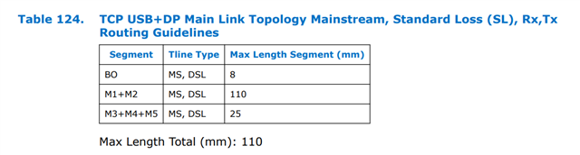

Hi Robin,
I was able to get the PDG for the Novalake. In section 5.1.5.1 it describes the maximum trace length for USB Type-C.
hi Vishesh,
110mm = 4.3inches
so we redriver can add another about ~12inch,
so total can support 16inches?

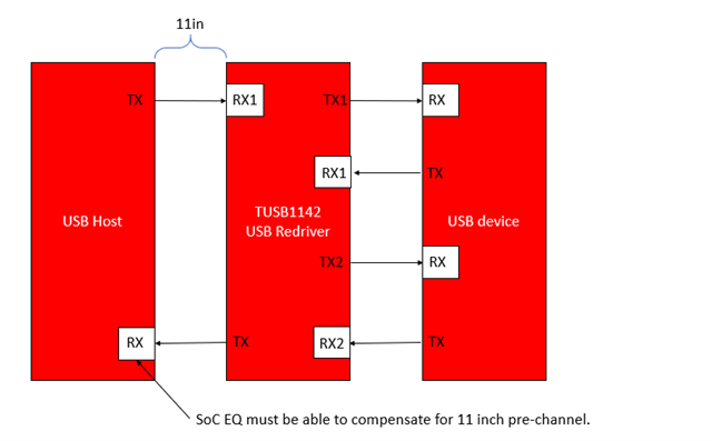

I believe the 12ich approximation is coming from 12dB max gain provided by the redriver. The approximation is about 1dB/inch which is correct. However the assumption behind this approximation is that the trace is straight and has no vias. I believe 11inches pre-channel has a possibility of failing compliance due to the channel length + vias + curves in the traces. The is also a possibility we pass without issue, but I believe this is still a riskier option.
Additionally, Are you able to confirm with the SoC vendor what the EQ capability of the SoC is? The TUSB1142 can only compensate in the RX, so the SoC will also have to compensate for the 12inch channel in the TX directions.
Ex) white boxes represent where EQ can be applied.
