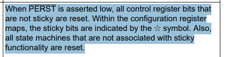

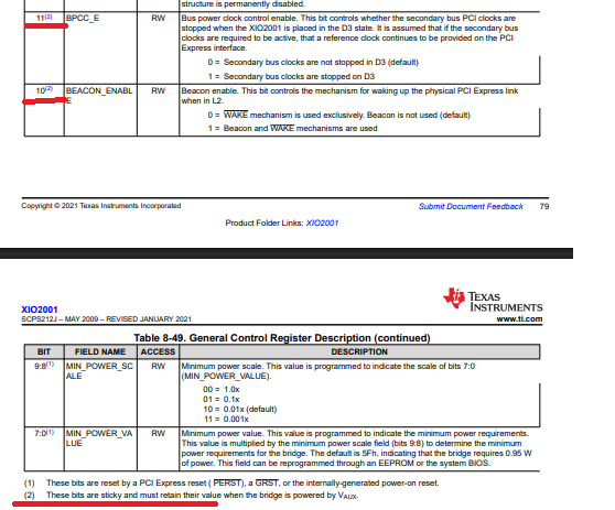

Hi Brian,
According to table 8-1, /PERST is used to reset all control register bis that are not indicated by d by the ☆ symbol. Is this right?
However, I can't see any registers with the ☆ symbol in the datasheet. How should I understand registers for /PERST?

Hi Noriyuki :
It seems datasheet is not consistent, bit with (2) are sticky bits.
