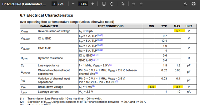

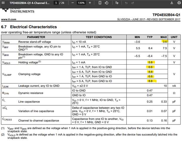

Could you help select suitable ESD protection device selection for TPS25854-Q1 D+ and D-? Below are candidate.
  • 2ch: TPD2E2U06-Q1
  • 4ch with low voltage: TPD4E02B04-Q1

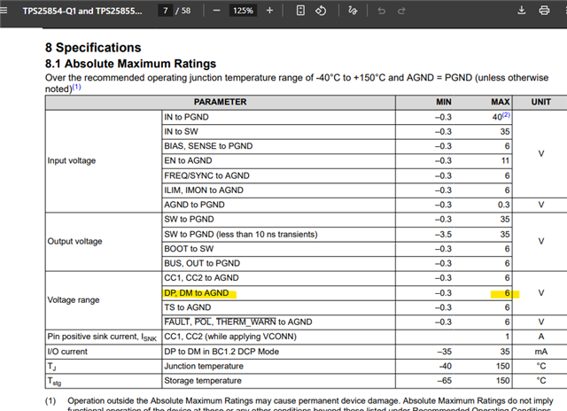

ESD protectoin is for TPS25854-Q1 D+ and D- absmax is +6V. On the ohter hand, ESD protection device breakdown voltage are higher than TPS25854-Q1 absmax. Are they right device?

    Typically, we recommend selecting a diode with a clamping voltage around the absolute maximum, and as you have shown, these devices have a higher clamping voltage compared to the abs max of the TPS25854-Q1 device. It is possible that TPD4E02B04-Q1 would be suitable since there is ~1V variation in DC abs max vs AC abs max, but testing in the customer's system would need to be done to verify this, as this may also depend on other components in the system.
    It would also be possible to place a resistor downstream from the diode to create a voltage drop to lower the effective voltage that the downstream IC will see. I am not sure if this will be practical to implement, but selecting the appropriate resistor value might allow for either of these devices to properly protect the TPS25854-Q1 device.

    >By "impedance budget", are you referring to the differential impedance variation for USB data lines? The TPS25854-Q1's DP/DM pins are not for USB 2.0 data transmission. It is only for BC1.2 legacy charging, which are not differential and digital signals that require impedance matching.

    Looking at TI's ESD protection portfolio, the clamping values shown in the datasheet are often higher than the 6V abs max that we are trying to protect against. It is worth stating that some of these values are taken at large test conditions (for instance, ESD321 has a 6.3V clamp at IPP of 6A, but at lower currents, this device would possibly clamp below 6V). I am looking to recommend a device that can protect TPS25854 regardless of the expected transient event, but if you have an expected transient that you are wanting to protect against, I can confirm if we have a device that can clamp below 6V for that condition.
    I was referring to the total impedance allowed to not impact signal integrity. If there is impedance available to add to the line without impacting the signal, we can add a resistor to step down the clamping voltage to an acceptable value. For now, I will assume this is not an option unless we can confirm otherwise.
    >If you are simply helping a customer find the right external ESD protection device for the TPS25854-Q1's DP/DM pins that is suitable for 6V abs max, is the INT-PD team saying that there isn't any other device to recommend?
    As mentioned above, I cannot recommend a device without considering a specific test condition. If you are able to share a specific transient (according to IEC 61000-4-2/5), this can help me provide a device with more confidence.

    For TPS25854-Q1 DP\DM/CC1/CC2 ESD protection, we need IEC 61000-4-2 or ISO10605 for ESD rating. Could you check if TPD2E2U06-Q1 supports that? Or could you share ohter recommmended parts?
    Considering layout, I appreciate if you propose 1CH, 2CH ESD protection device instead of proposing only 4CH version.
    Ochi
  • Hi Ochi-san,
    TPD2E2U06-Q1 (2CH) supports the below:
    For a 1CH solution, I would recommend ESD321 as brought up before, which can support the below:
    Please let me know if you have any additional questions.
    Josh Prushing
