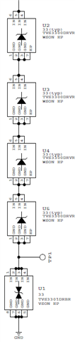

    could you please help me understand whether it's possible to connect multiple unidirectional or bidirectional clamping devices in series to achieve a specific clamping voltage? For instance, in my case, I’m aiming for a clamp around +200V & -40V
    Would this approach be feasible, or are there limitations I should be aware of?
  • Hi Kartik,
    You can add devices in series to sum the following parameters:
    • Working Voltage
    • Breakdown Voltage
    • Clamping Voltage
    • Capacitance
    • Leakage Current
    As you stack multiple devices in series, your capacitance and leakage current will be very high, especially if you stack 5 devices together! Maybe for the application this is not a concern, but this is important to keep in mind.
    Another limitation is the Surge rating and the ESD rating of the devices (IEC 61000-4-2/5 standard ratings). These values will be limited by the minimum protection value provided by a singular device in the chain. This really only matters if you are stacking different devices, as if you are stacking multiple of the same device, the effective ESD/Surge ratings will be the same no matter how many of that device you stack.
    Stacking 5x TVS3300 would provide the following specifications:
    Vrwm (V) 165V
    Breakdown Voltage Min (V) 170V
    Breakdown Voltage Max (V) 195V
    Clamping Voltage Min (V) 170V
    Clamping Voltage Max (V) 200V
    Forward Clamp Voltage Min (V) 5V
    Forward Clamp Voltage Max (V) 25V
    IO Capacitance (typ) (pF) 650pF
    IEC 61000-4-5 (A) 35A
    IEC 61000-4-2 Contact (kV) 11kV
    Max Leakage Current (nA) 750nA
    This seems to work well for your positive clamping target, but not the negative clamping target. Are you ok with a lower negative clamping voltage?
