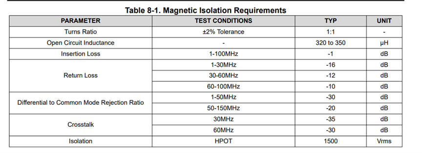

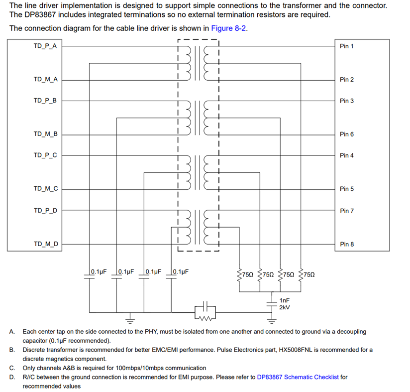

We are planning to use the RJMG2330A1610ER (Amphenol) in our design due to space constraints. It is a stacked RJ45 + USB A connector with integrated magnetics, rated for 1000BASE-T and AutoMDIX.
Our PHY is DP83867IRRGZT, and we noticed that the internal magnetics configuration of RJMG2330A1610ER differs from the transformer topology recommended in TI’s reference designs.
Can you confirm if this connector is compatible with DP83867IRRGZT?
Specifically:
  • Are the internal magnetics suitable for the PHY’s signal requirements?
  • Is the center tap biasing and termination network aligned with TI’s recommendations?
  • Any known issues or design caveats when using this connector with DP83867IRRGZT?
