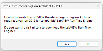

  • I'm trying to install the application "Texas Instruments SigCon Architect EVM GUI Setup" to connect an EVM via USB. However, I'm encountering an error—even after installing LVRTE2012_f3Patch-64std. Could you please share the exact LabVIEW Runtime Engine file required for proper installation?
  • Hi Prashanth,
    Which location did you download SigCon Architect from? Some installers for it on TI.com do not contain the LabVIEW RTE. The ZIP file in the DS160PT801 secure folder does contain the RTE as well as the DS160PT801 profile. If your current installer doesn't mention RTE in the filename, you can try uninstalling it, and then using the secure folder installer.

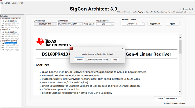

    Dear TI Support Team,
    We have installed SigCon Architect version 3.0.0.14 and attempted to bring up the DS160PT801x16 EVM. However, we encountered the following error:
    "Invalid Address or Device Not Active!!" PFA the screen shot FYR
    Could you please confirm whether version 3.0.0.16 is required for proper operation with this EVM? If so, we kindly request access to the installer for SigCon Architect v3.0.0.16 and the appropriate device profile for the DS160PT801.
    If the issue is unrelated to the software version, we would appreciate your guidance in identifying the root cause of this error.
    Thank you for your support.
    Prashanth Pai B

  • Hi Prashanth,
    - To clarify, please use the following software to avoid the initial error with the system unable to locate the run-time engine:
               SIGCONARCHITECT3-WRTE — Texas Instruments SigCon Architect EVM GUI v3 Setup with RTE
    - In your screenshot, what device profile do you have selected? it looks like the current selection says DS160PR410. This is what my SigCon Architect GUI looks like for the device:
    Greg
