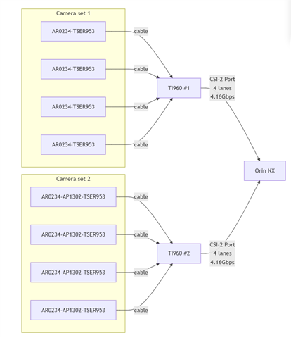

Hi Ti team,
We need two configurations for Ti960+Ti953, can you provide it?
configuration1:One Ti960 is connected to four Ti953 devices. The data format of the sensor(AR0234) output is 4lane raw10, vc-id=0.
                        The output of Ti960 is 4.16G, 4lane.Use virtual id to distinguish the four sensors.
configuration2:One Ti960 is connected to four Ti953 devices. The data format of the ISP(AP1302) output is 4lane Yuv422(8bit),vc-id=0.
Also, Please provide the configurations for the two synchronization methods.
1.We used external SYNC from GPIO7 of Ti960, and output from GPIO0 of Ti953
2.Use Ti960 internally generate a FrameSync signal 25FPS(Please provide the method for calculating frequency,We will employ multiple frequencies),and output from GPIO0 of Ti953

  • Are you using FPD-Link devices DS90UB960-Q1 and DS90UB953-Q1 or V3Link devices TDES960 and TSER953?
    -------->Regarding this question, I need to first confirm with you whether the DS90UB960-Q1 can be used in conjunction with the TSER953?
    We will use DS90UB960-Q1+ TSER953 as our project.
    We also will usd DS90UB960-Q1+ DS90UB953-Q1 as early development,
    So I want to have two configurations:
    1.DS90UB960-Q1 and DS90UB953-Q1
    2.DS90UB960-Q1 and TSER953
    Do the sensor and ISP CSI-2 outputs use continuous clock?
    -------->Yes, use continuous clock.
    What is the data rate per lane of sensor and ISP CSI-2 outputs?
    -------->Our sensor will work on some different modes, and the datarate of sensor and ISP has 330Mbps/lane, 248Mbps/lane and so on, So can you also provide the method when I change data rate.
    Is an external oscillator used in camera modules?
    -------->Yes, it's 27MHz.
    Is 953 CLK_OUT feature needed to provide a reference clock to sensor and ISP devices? If yes, what clock frequency is needed?
    -------->No, don't need.
    Note that 4.16Gbps is the max supported data rate of the forward channel (953 output / 960 input). Is this the intended data rate of the forward channel? Note that there is some dependency on oscillator frequency.
    -------->Yes, since we may not use all 4.16G bandwidth.
    Do you intend to use synchronous or asynchronous clocking mode for the link between 960 and 953?
    -------->Use asynchronous clocking.
    What forwarding method do you intend to use with the 960? The following synchronized forwarding methods are supported: basic sync, line-interleaved, line-concatenated.
    -------->basic sync
    When internally generated FrameSync signal is used, what high/low duty cycle do you intend to use? (for example 50% high / 50% low)
    -------->10% high / 90% low.
    Should the 960 output come from CSI port 0 or CSI port 1?
    -------->from CSI port 0.
    What data rate per lane do you intend to use for the 960 CSI-2 output? Note that 960 supports up to 1.664Gbps per lane but there is some dependency on oscillator frequency.
    -------->Yes, we want to use max bandwidth of 960. Our platform can support up to 2.5G/lane.
    Do you intend to use skew calibration (initial or periodic) on the 960 CSI-2 output? Note that this is usually recommended when the output data rate per lane is greater than 1.6Gbps.
    -------->If output data rate per lane is greater than 1.5Gbps, we should add skew.
    Should continuous clock be used on the 960 CSI-2 output?
    -------->Yes,use continuous clock.

  • Hi Zhang,
    Note that V3Link and FPD-Link devices are not cross compatible. TDES960 can only be used with TSER953 and DS90UB953 can only be used with DS90UB960 or other FPD-Link deserializers.
    Note that in asynchronous clocking mode, the forward channel data rate is dependent on the frequency of the external oscillator connected to the 953. If a 27MHz oscillator is used, the forward channel rate is 2.16Gbps and the max CSI bandwidth is 1.728Gbps. If the max bandwidth needed is 330Mbps/lane * 4 lanes = 1.32Gbps, then 27MHz oscillator is sufficient.
    Here is a bring up script which can be used to configure 960 and 953 in your setup. This script can be used with TSER953 + TDES960 or DS90UB953 + DS90UB960.

  • Hi Lucas,
    I'm currently testing with the configuration of the first route.But I can not visit sensor,(8bit slave address, 16 bit register address, 16 bit register value)
    I used " DS90UB960-Q1EVM" and part of the setting you provide (show in the last of this message), I tried to visit below register of sensor,
    So can you help me to connect sensor by DS90UB960-Q1EVM, I want to use this EVM to configure sensor and UB960+UB953 for early development.
    Another question is that I found when configure different address of ser,sensor,isp, you use the same register of UB960(0x5B,0x5C,0x5D,0x65,0x5E,0x66),
    though you select different RX port, will this mutual interference?
