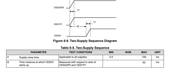

    Two-supply mode (VDDIO, VDD1P1, VDDA2P5) has the following specific sequence requirements:
    We require VDDIO to power up after 1.1 and 2.5V.

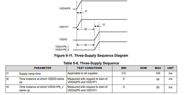

    Three-supply mode (VDDIO, VDD1P1, VDDA2P5, VDDA1P8) has the following sequence requirements:
    We require 1.1V and 2.5V to power up before other supplies.

  • Hi Manish,
    Got it , so 1.1V and 2.5V are mandatory and then it depends whether you use only VDDIO or VDDA1P8 along with VDDIO. IS THAT RIGHT?
    1.1V, 2.5V, and VDDIO are mandatory in either mode. But, VDDIO can be selected from 1.8V, 2.5V, and 3.3V.
    In three-supply, you will have to provide 1.8V in addition to the aforementioned voltages.
    Also, what sections do these power rails supply inside the IC ? And how would I know if I want to use two supply mode or three supply mode as mentioned in your response ?
    All of the IC is powered whether you use two supply or three supply configuration. We offer three supply configuration as a way to reduce power consumption. Therefore, you can base which supply to use based on the power consumption. I recommend to look over page 13 of the datasheet and this document. The document is for 867 but these would be a good comparison to see what the power consumption difference is for two and three supply configuration.
