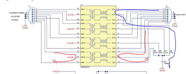

When Delta design the Ethernet PHY, DP 83867,   they selected  C6 package to 0805,  NOT 1206.  But there is no 0805 MLCC capacitor which can support up to 2KV,  then   2 pcs 0805 MLCC in series used.

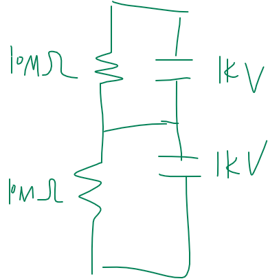

The real circuit  as following used to replace C6 in the above:
Q1: Do you think  whether the above network will degrade  the Ethernet data performance, such as the eye diagram?
Q2:  Whether it will degrade EMI performance?   for example:  +/-4KV ESD etc.
Thanks a lot!

    The 1000nF is part of the Bob Smith Termination. A Bob Smith termination with a 1000pF capacitor is a standard circuit to manage common-mode noise and protect against static discharge. The capacitor coupled the high-frequency common-mode noise to ground while blocking the DC voltage.
    The proposed schematic deviates from the Bob Smith termination and this is something we have not tested before, so I can not comment is performance against common mode noise suppression and ESD performance.
