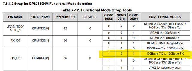

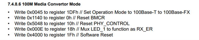

    We expect DP83869HM to work the same way as RTL8201FC. DP83869HM can be programmed two ways: HW or SW.
    For SW method, please do the following writes:

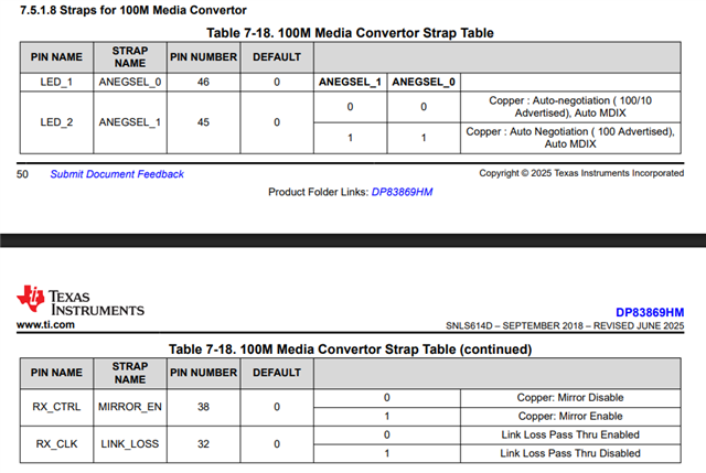

    For HW method, the following strap configuration must be done for the pins mentioned in the below table:
    Please note that 10M media conversion is not supported on DP83869.
